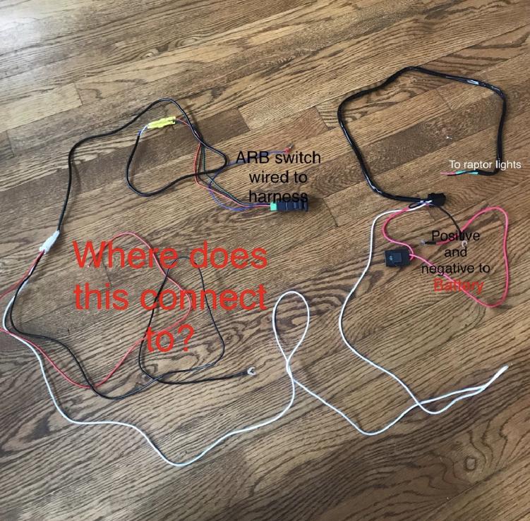

Yes these are for raptor lights, let me explain with pics of what I have so far. Because I feel like we’re going around in circles lol.

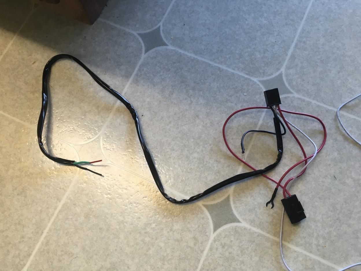

This is the where the raptor lights are connected to, (green and red)
You can see the relay and red and black to the battery
From the relay comes out a white wire

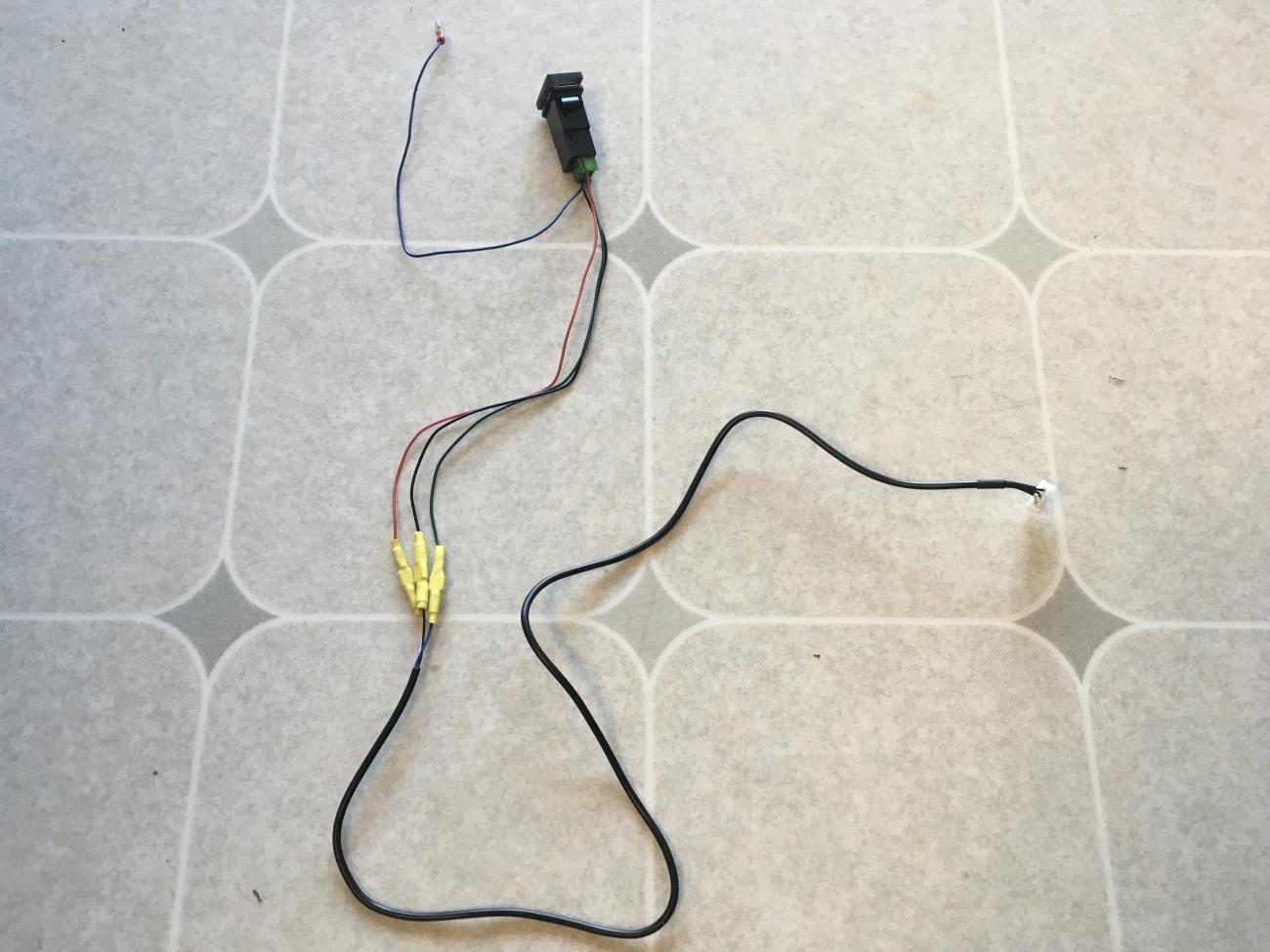

Next is the ARB switch connected to the Amazon harness, I connected them according to the diagrams from ARB and the Amazon switch.
Note (blue is for the backlight function, that I know about)
*****look at the white connector, and remember it for the next pic*****

I had to post a link because I couldn’t upload the pic. So this is the confusing part. After I connect the switch hardness and the relay harness via the white connector, I’m left with a red and black.
That’s what led me to believe that something is not right with my Amazon harness. One one white wire running to/from relay that connects to my switch.

Okay let me see if I am understanding correctly: The issue is that you do not know where the red wire coming from your switch goes to?
If that is the case, wire it to your fuse box (drivers side under the dash) using an Add-A-Fuse in the WIP (Wipers) fuse slot (use like a 5amp fuse). This only has power when the key is in the ignition or when the engine is running. This will give your switch LED's power and allow your switch (when enabled) to give the OK for your relay to draw power from your battery.

If you took that red wire and ran to battery and the raptor lights were always on, then running it to something that was only hot when the vehicle is on should be your fix.

It did come with an ad a fuse so no issues there. So this goes back to my other question a few posts back...... essentially the blue backlight and the red would have to be wired together and into the add a fuse, so that the back light function works and also the switch now has power to trip the relay right?

When I connect the the red wire to the battery directly everything functions correctly except the switch turns on and off even when the vehicle is off, so you’re correct. I’m thinking maybe I did something wrong when you told me to connect the red via add a fuse, I’m gonna go re do it and try again.

Yeah, that's what I am thinking. If you hook it up to battery and the raptor lights can be turned on and off with the switch then that should be your fix.

It sounds like you simply need to connect the blue/red together with an Add-A-Fuse into a the fuse box under the drivers side dash into a fuse slot that ONLY gets power when the key is in or the engine is on.
Again, I recommend the fuse slot called "WIP" which is power for the wipers which is a fuse slot that only gets power when the key is in of the engine is on.

I will do just that. Thanks everyone

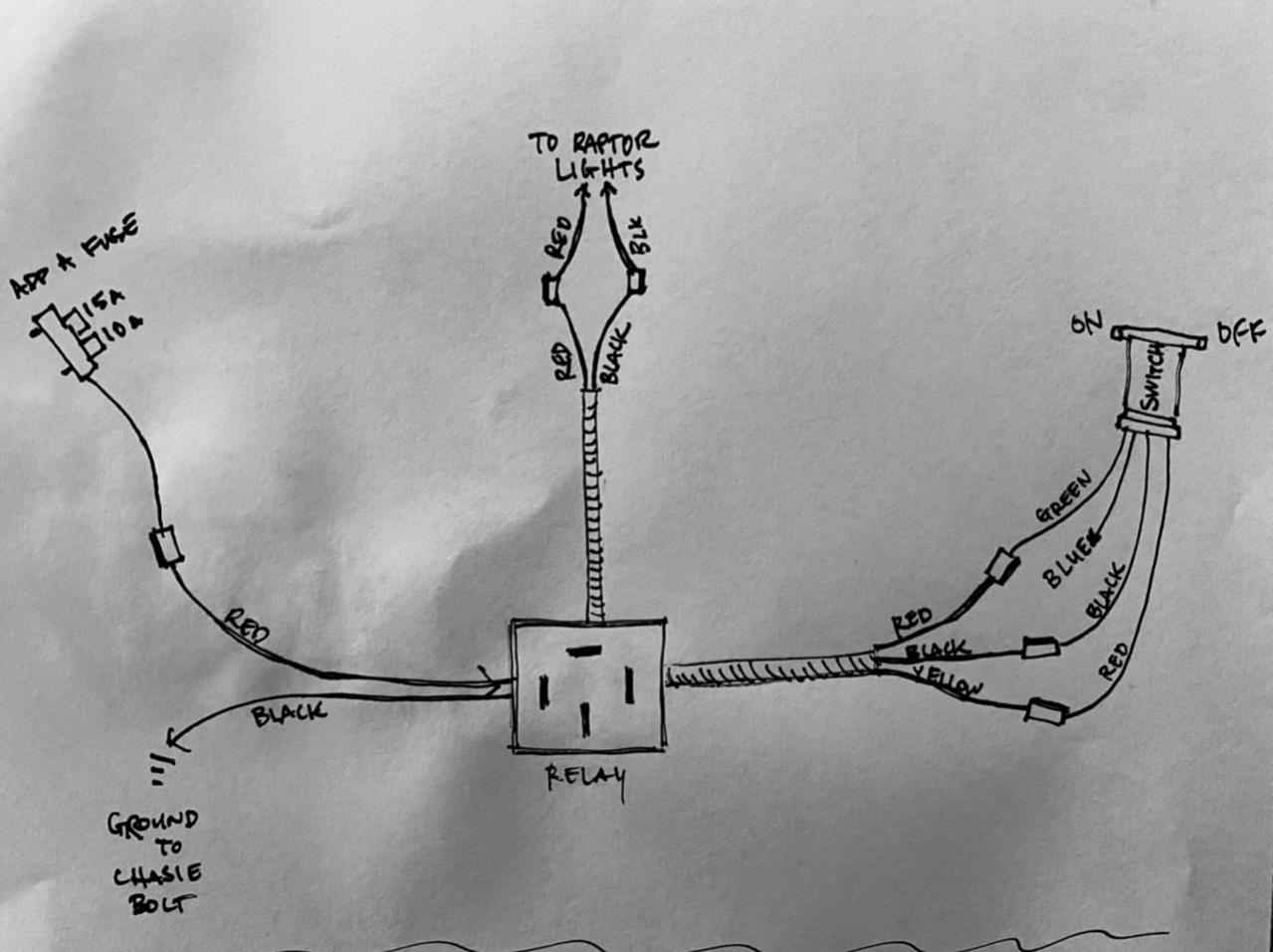

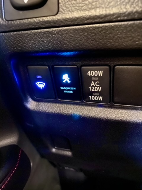

I just wired my raptor lights up to a switch (“Sasquatch Lights” bc there was no raptor or marker lights option) from aironboard.com.
I also used a relay wiring harness I got from Amazon that people buy aftermarket for light bars ditch light etc.
Took me a while to figure it all out bc I had to cut and splice and modify the relay harness to fit my needs. I also didn’t want it powered directly from the battery (+) terminal because I feared I’d forget to turn the switch off after leaving my vehicle and either they would remain on or the small light in the switch itself would still be lit up.
So I wired the positive red power in to the add a fuse (came with raptor lights) that goes to the 10amp ENG fuse in the engine bay. Now switch functionality and light only work when engine is on.
Attached is a drawing of how I wired, cut, and modified everything. Hope this helps people that want a switch option for lights and also don’t want them to always have power even after car is turned off.
I am by no means an expert, this is just what I figured out after watching a bunch of YouTube videos and reading the forums. Do the same at your own risk! Haha, but really it works, wasn’t to hard, and I think it’s a safe option.

It’s funny because I have the exact same wiring harness, but still can figure out what to do with the extra RED lol
Is have a white from the relay to the original Amazon button, but then end up with a ground and red out of the white connnector?..
