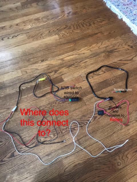

Pardon my lack experience here, but I have a small issue I’m trying to resolve. I ordered this exact wiring harness from Amazon. I followed your direction from the previous posts and connected the raptor lights to the black and white coming out of the relay. Then ran the switch inside and connected it to my AOB switch...now I’m starring at a black and red wire that comes out of the white connector that goes to the Amazon switch. Where did you connect the red to?
I tried the red directly to the battery, but the raptor lights comes on even when the vehicle is off and no key in the ignition. Is that how it’s suppose to be?
The black is obviously ground, but I’m just so confused by the red wire.

I am assuming you are talking about the wire that should either go to an "add a fuse", you can tap into a fuse that is "hot" when the vehicle is on. You can also just tap into the parking light wire, so the raptor lights are only on when your headlights are on. It just depends on how you want it.

See if this pic helps. My blue coming from the ARB switch is the one I had connected with an add a fuse so it lights up when I turn the key. If I’m understanding you correctly then I would end up with 2 add a fuses? Thanks

You don't need to have 2 add a fuses, you can have both wires going into the crimp part on the same add a fuse.

I’m I’m gonna try that. Is it correct that the high voltage is only drawn through the relay? So there is never any chance of any short or melting in the switch harness?

Tried and didn’t work. It appears that even though I bought the same harness as mentioned earlier, it’s not correct for my application. I only have 1 single white wire going from the relay towards the ARB switch. And just before the switch it splits into 3.
