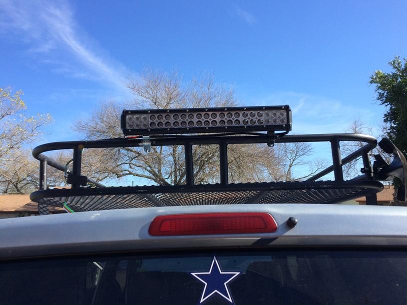

I mounted an LED bar on the rear of my rack. The rear hatch is a great place to do the wiring, without having to drill through the cab. I also used a trailer connector, so I could take the LED bar off. I don't want it to get stolen. Plus, it makes it so the rack can be taken off with little effort.
I ran the wire down the side of my windscreen. There is actually a small groove in the windscreen moulding and the wire fits snugly in there. Has been there for a few years now with no problems. From there I ran it through and under the cowl directly to the relay and then the battery.
