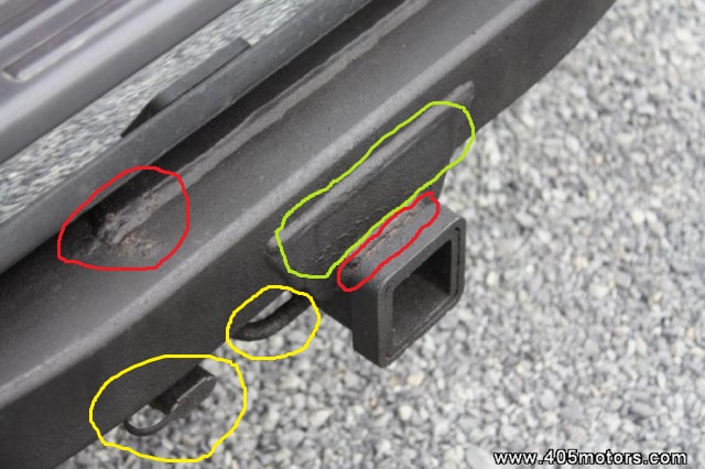

Wondering if someone would be will to check out a truck for me?

some how these guys always seam to find 3rd gen 4runner with unheard of low miles... it makes me wonder if they are just rolling back the odometer. and for $20k its a joke, you could buy a nice 4th gen for that price. there is nothing special about that rig. it isnt a 5spd, it doesnt have the locker. as stated above i would wonder about the condition of other things like seals and hoses as well as fluids. the fact that there is rust on the tow hitch and that its been repainted makes me think this is a truck that they bought at auction and rolled back the odometer and cleaned up, or fixed. id pass for that price you could have two nice 3rd gens or one epicly custom set up back country/expedition runner.
hell it doesnt even have the factory projector fog lights, or the rear cargo cover. its not worth it man sorry

I looked at the history of that truck and it's been drive 1-2k miles a year, consistently. The little spot of rust on the hitch was not appealing, how can you tell it's been repainted? Just the hitch?

the sticker above the 2" receiver is covered, you can see its outline and they painted over the rust in that spot, on top, then down below where the sticker is(was) and where the 2" receiver comes out, there is rust along that weld, that they tryed to paint over... the res circle are of the clearly rusted areas the green is of the sticker they painted over and the yellow are of areas that also have been painted, the trailer light plug in has the same texture and color as the tow bar, its not steel like the tow bar, its just a rubber cap, and the lower safety chain loops are smooth from the factory and these are textured. this thing has been repainted, to cover lots of rust in my guess, i bet if you look under it the spare wheel will be rusted like crazy along with rust all over the frame...
