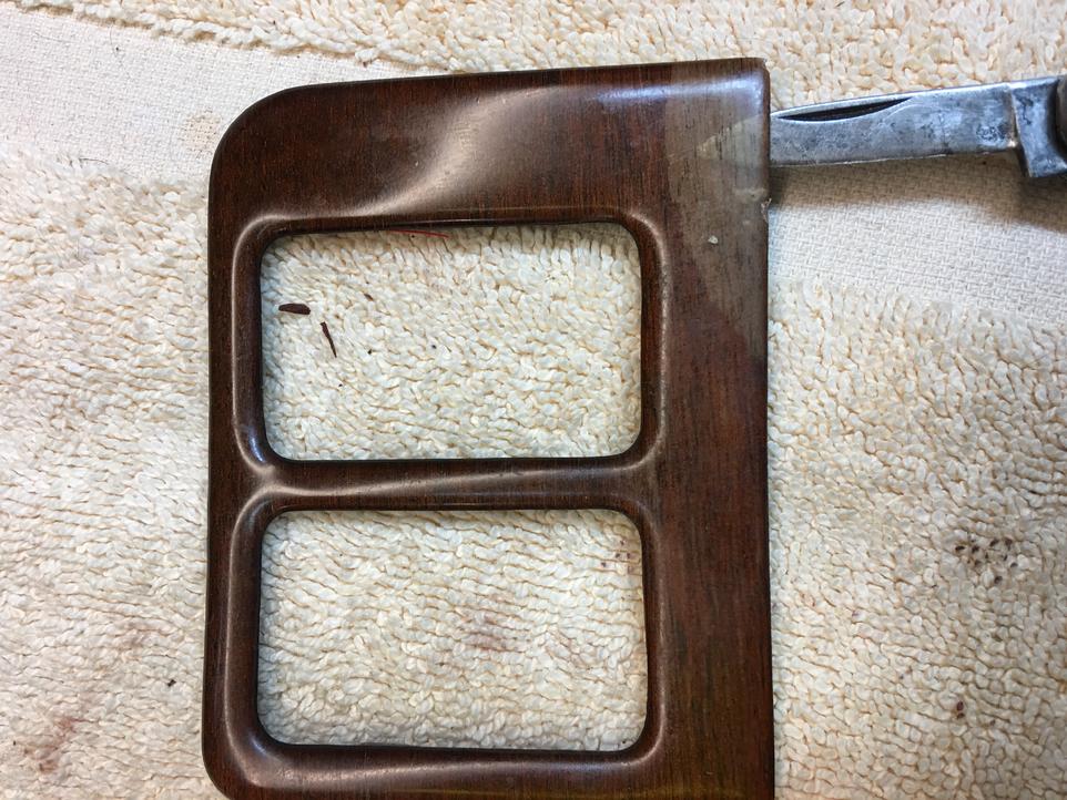

i used a putty knife and removed all the wood. removed what was left of the adhesive then sanded it down with 400 grit. then painted with krylon fusion spray paint. a little dusty but i like they way it turned out.

I did it. Removed limited bezels and replaced with remod wood grain

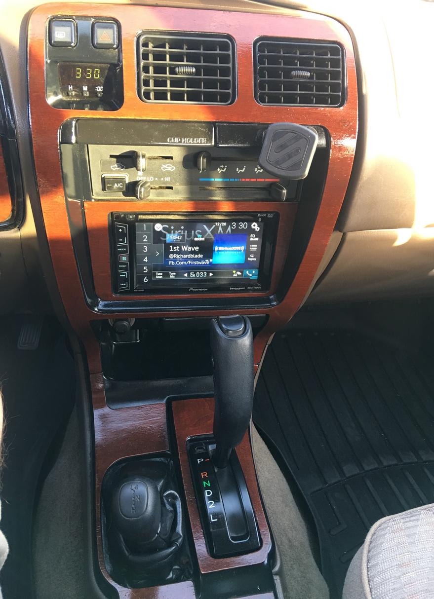

That didn’t work for me. Tried that and even wall paper remover to melt resin, didn’t work
Had to pry off using knife
Used wood stain after lightly sanding with 300 grit. Then sprayed with clear coat
