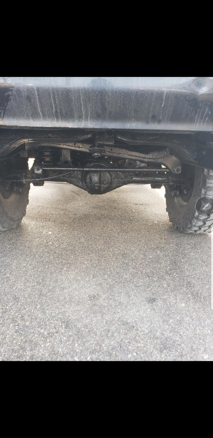

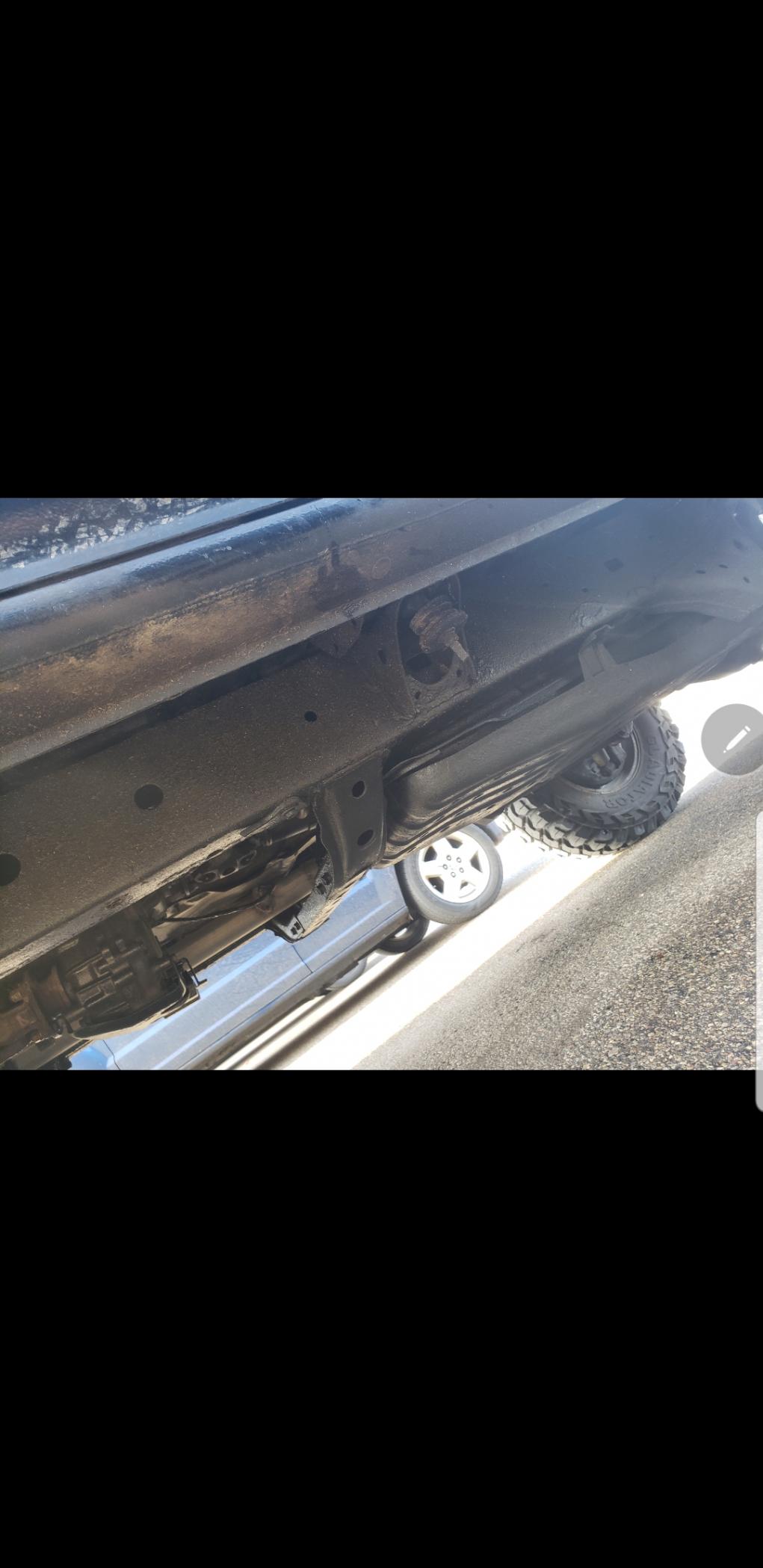

I undercoated my 3rd gen as some added insurance to all of the frame / undercarriage work I did this past summer. I must say this product has me completely satisfied.
I applied the undercoating with a Wagner electric paint gun. (HVLP) and it came out perfectly. I purchased a gallon of the black color undercoating (Woolwax Brand) and I let it set for just over a month before finally washing my truck today. Personally i was scared that it would all wash off if i got a car wash immediately and slowly it turned from an oil texture to a heavy dirty grease texture which is what I wanted. I went through a full service touch car wash with an undercarriage wash because I have an unlimited membership with the local company and these are the results. Honestly I cant tell a difference after the first wash. However I'm going to take some time tomorrow to reapply a second coat because the weather is warm in Michigan right now and I'll more than likely only get one car wash per month this winter to keep the coating as thick as possible. I use a flag mount on my front bumper as a gauge for how the rest of the truck looks.
Anyways, for any undercoating questions this is the real deal. In addition to that I'll apply some WD-40 on the inside of the frame because I dont want something this thick in there. I hit up the sand dunes all summer with my truck and I'm not looking to get the entire inside of my frame filled with a sandy thick oil lol.

Wool wax is similar to Fluid Film. Just comes in black. I even use the woolwax guns and containers when I coat my rides undercarriages, inside panels etc.
WD-40 will work great inside your frame. I know FF does too, when I rebuild frames, I remove the frame holes so I don't have to worry about coating the inside of the frames ever again. The Salt belt is just a killer on all rides. :-(
Looks Great VernySanders. :-)

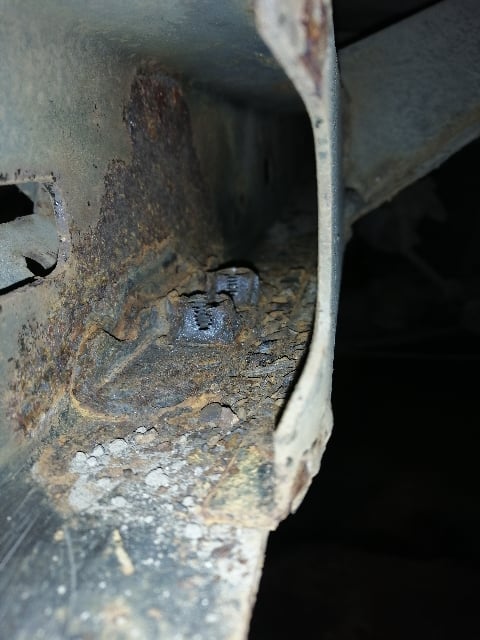

The crap gets up where you won't see it and stays there. That's where the rot starts in, rust belt or not. Found this inside the rear framerails of my relatively rust free runner. There was some silty soil up around the crossmembers, packed on the spare wheel, really anywhere that could hold onto it.
This type of soil is not like a thick clay or even a mucky loamy soil, those would dry out and cake on. Silt will absorb the moisture out of the air and stay damp, starting to eat away at the metal over time.
Just because you aren't in the "rust belt" doesn't necessarily mean you don't have something to worry about.

Ah. I would imagine lots of these super clean outer frame 3rd Gens inner frames look like yours. If not kept washed clean or coated with rust protection fluids. This is one of the reasons I suggested people look inside their frames with an inspection camera. Thanks for the Feed back UnderFire. This completely makes sense. I also suspected this was the case.
Now the 4 Runners that spend their lives in the super dry deserts would probably be the only exceptions.
