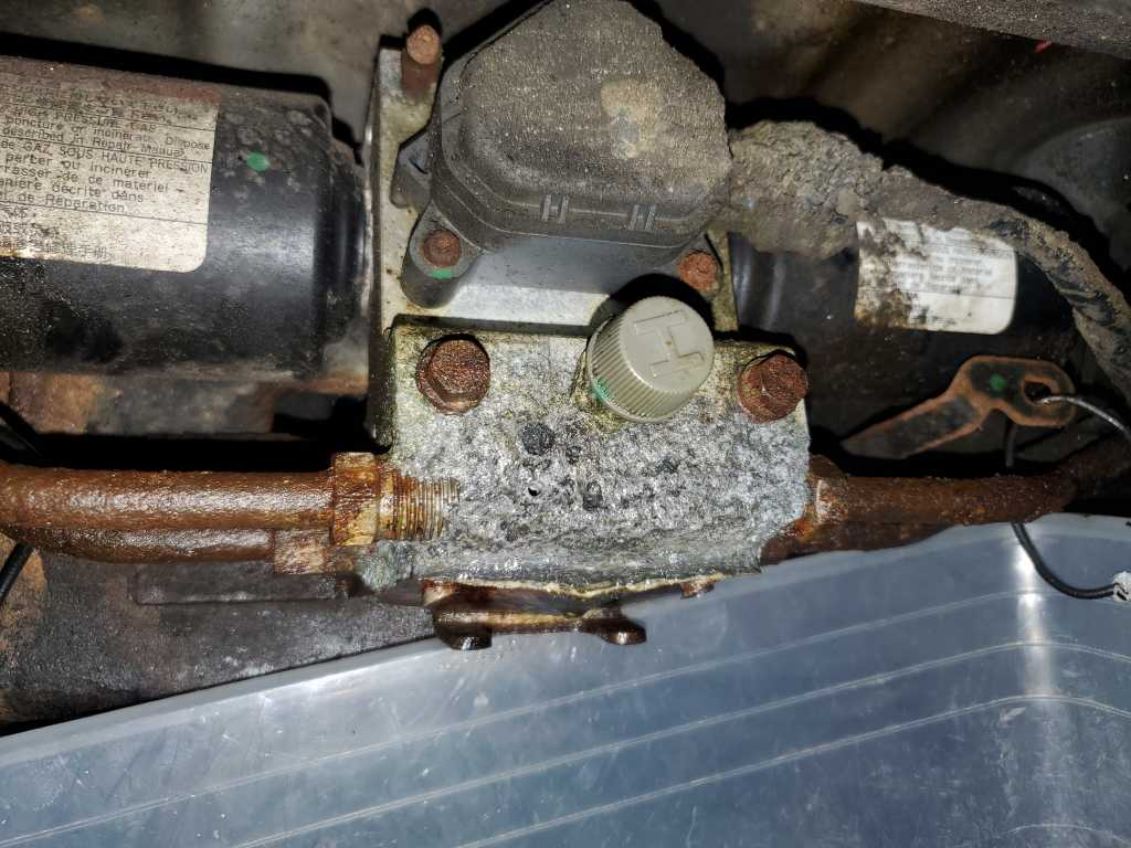

Thank you for the replies. Anyone else have a vote? I guess if I add some material there I might be inviting more corrosion to happen underneath the filler. I'm glad I took pics because I can see that I need to do some more cleaning under the bracket in the back of the accumulator. I have wheel cleaner and assume that would do a good job in cleaning up the aluminum before I coat it. I am thinking it would be best to coat the lines in POR15 before I do that. I don't want anything on them that might cause it to not adhere.
And I know some of you live where they don't salt the roads but I still urge you to just take off those 2 12mm bolts and pull that cover to clean and inspect! I wish I would have known sooner. Looking at POR15, I'm thinking now that I can also apply it to the aluminum before coating in WoolWax. Not sure how to proceed here. Until I get this done, my 4R will stay parked! It's 20 degrees here today so I plan on tackling it tomorrow. Thanks again for all the advice!

In regards to yours, I'm not quite sure what you can do for that at this point except fluid film it to attempt any further corrosion. I'd still be driving it, though. No sense parking it for a swaybar. If it goes, it goes. It may tomorrow, it may never.
Thanks Pedro, glad you got yours cleaned up! It's only parked until I get the KDSS coated and protected from further damage. I think I might just POR15 the whole thing before coating with WoolWax. I'm getting ready to head out and tackle that now.

Moved from Ohio to Arizona nearly two years ago… I feel for you! The salt is killer, did not mind leaving it behind. I would hesitate to apply an epoxy patching for the exact reason you cite. If it ever develops a seam it’ll hold salt, and you won’t know it until it’s too late.

Also, I wouldn't try to add any coatings to that, I do think you're just inviting trouble for corrosion under whatever you put on there. What did you use to clean it up?
Well the lines look pretty good, I was pleasantly surprised, but I'm pretty horrified at how much aluminum is missing from the module where that front line enters. I would like to add some material there, what do you suggest? Looks like JB Weld Water Weld epoxy putty might work pretty well.

The problem is that there is a cover over this that prevents the salt from getting washed off without actually removing the cover, no amount of undercarriage washing would have changed what I uncovered in that picture, unfortunately.

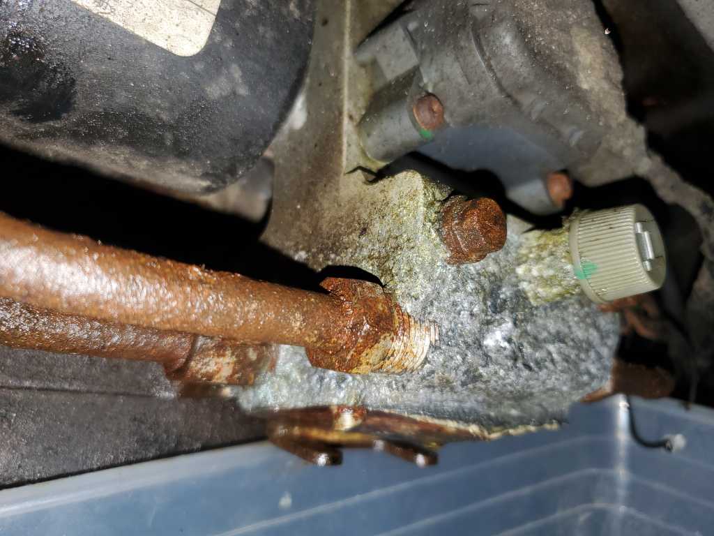

Well, I'll add my experience to this thread, with my 2013 4R TE.
I had to do an entire lift kit swap, due to rust breaking UCA's, coils. Had a shop install a Dobinsons setup and Treaty Oak KDSS spacer kit. Well, they never opened the valves to free flow the system.
I get home and see fluid dripping from the accumulator. After a few days spraying the shit out of the cover plate bolts, I gave up and drilled them out. I expected the worst and that's what I saw.
Aluminum has corroded from dirt and salt sitting on it, despite my spraying that area with water over several years.
I'm waiting on a new part to arrive from Japan ($593). My hope is to spray the lines, remove the fluid from the drain valve, remove the lines, carefully, and install the new part. Then I need to find a dealer to recharge it.

Holy crap that looks bad!
Any dealer can recharge the system, it's hoping a tech knows how to do it. You can also check Lexus dealers as the GX has the KDSS system too. Recharging and pressurizing the system requires a special service tool that the dealer may have to bring in.
So, to remove all the fluid, what's the procedure? I've checked several threads without a clear answer.
I'm thinking just connect to the H valve, undo both shutter valves a bit and press the H valve to a hose.
Or, just undo the bleed screw and let it come out.
Service manual says remove fluid through bleeder, then remove the lines before removing the accumulator. I don't think there's enough play in the setup to just pull out and replace the accumulator, without removing lines.
