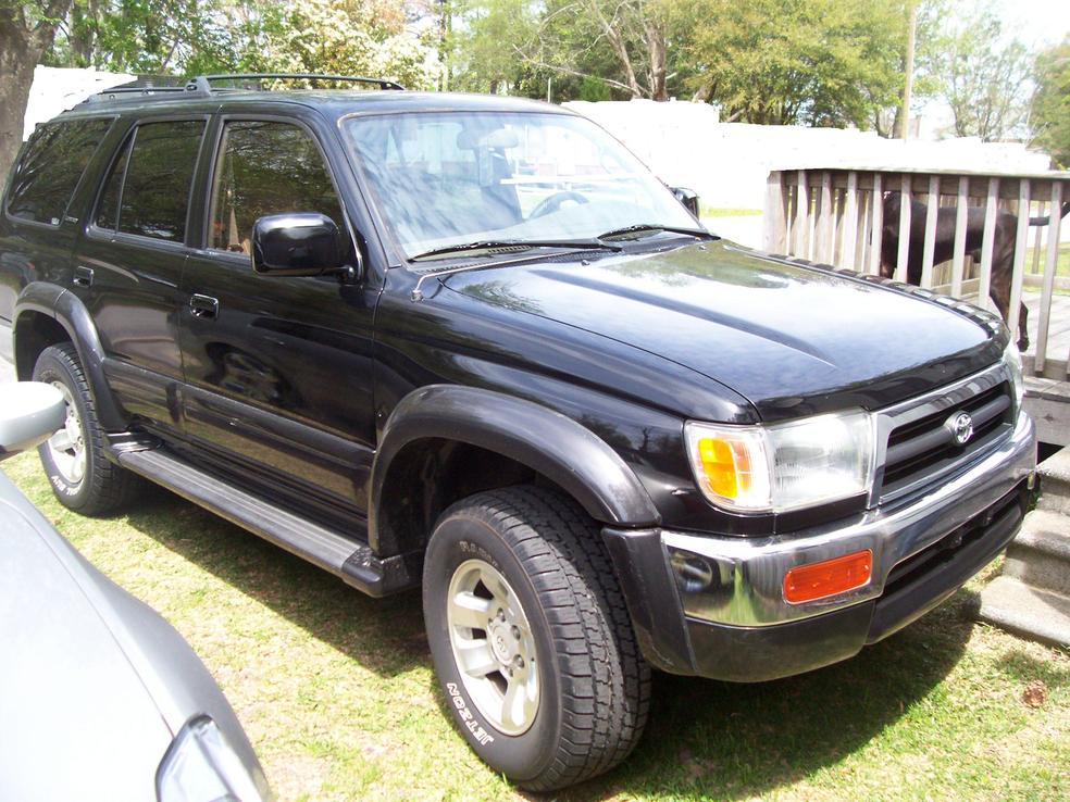

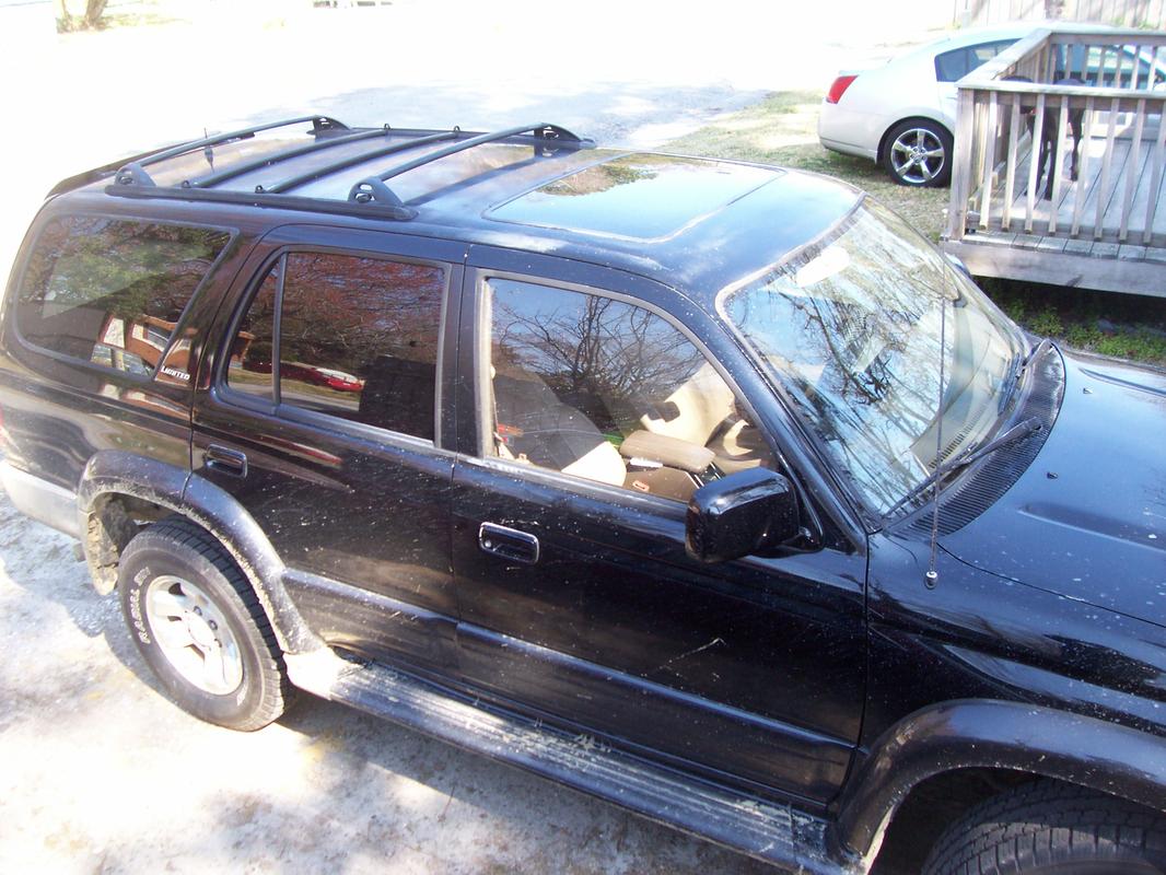

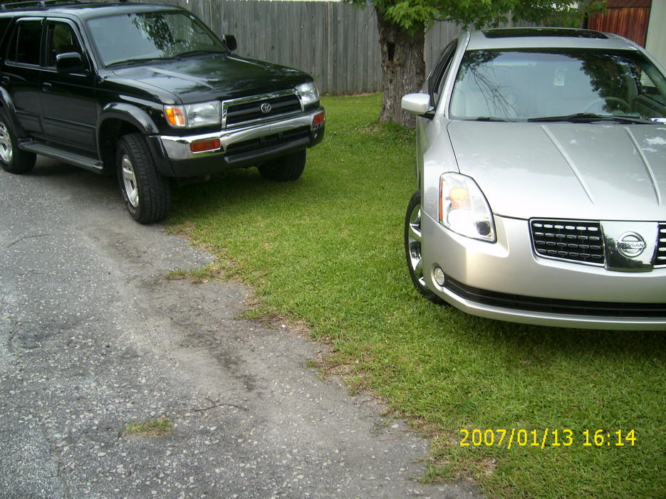

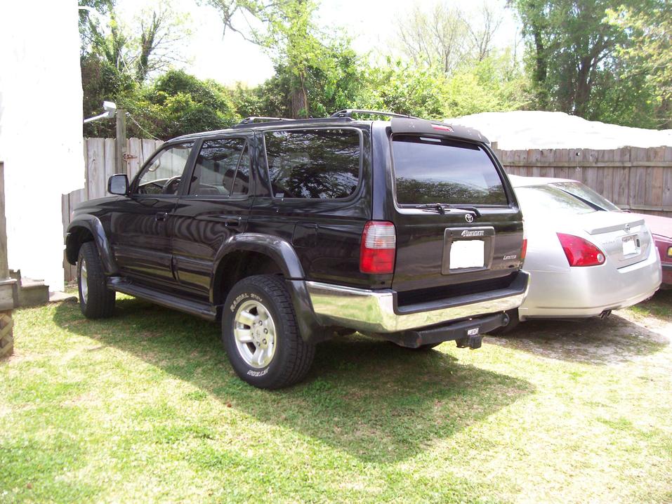

So i picked up my very first Runner( 96blkLimited, 70k, 4x4 auto w/lockers) 5months back.. Have not got a chance to really do work to her yet.. She was sitting for 5.5 years with no TLC before i bought her. thus far i have replace battery, fan clutch, radiator & all hoses, thermostat, brake pads & rotors. Truck in perfect condition now. Looking to get some suggestion on rims & tires (size), a lift, ( 2''-3'' which is best) shocks & struts also where i can find skid plates (not factory). i have a general idea of what the end outcome will be. Checkout the pictures and any suggestions are welcomed.

Sounds like you have a good start on the Maintenance.
Lift- Use search there are tons of postings on this and many opinions. Also more info would be needed to address your driving and usage. www.toyteclifts.com , www.sonoransteel.com , www.arbusa.com (OME-Old Man Emu)
Skids- www.budbuilt.com or www.skidplates.com (Skid Row)
Tires and wheels- again use search at least one or two threads a week discussing this.
Stock-3" 265/75/16 largest you can fit, 3" 285/75/16 or 255/85/16 both 33" equivalant
A lot of people recommend removing the runningboards (myself included) and once off leave as is or get Rock Sliders if you plan on wheeling. My theory is find what will suit you best and the way you use your truck and go from there.
Hopefully this answer with some non-answers and more guidance on where to look helps you out.

Lol, what happened to your antenna from pics 2 to 4? haha.
