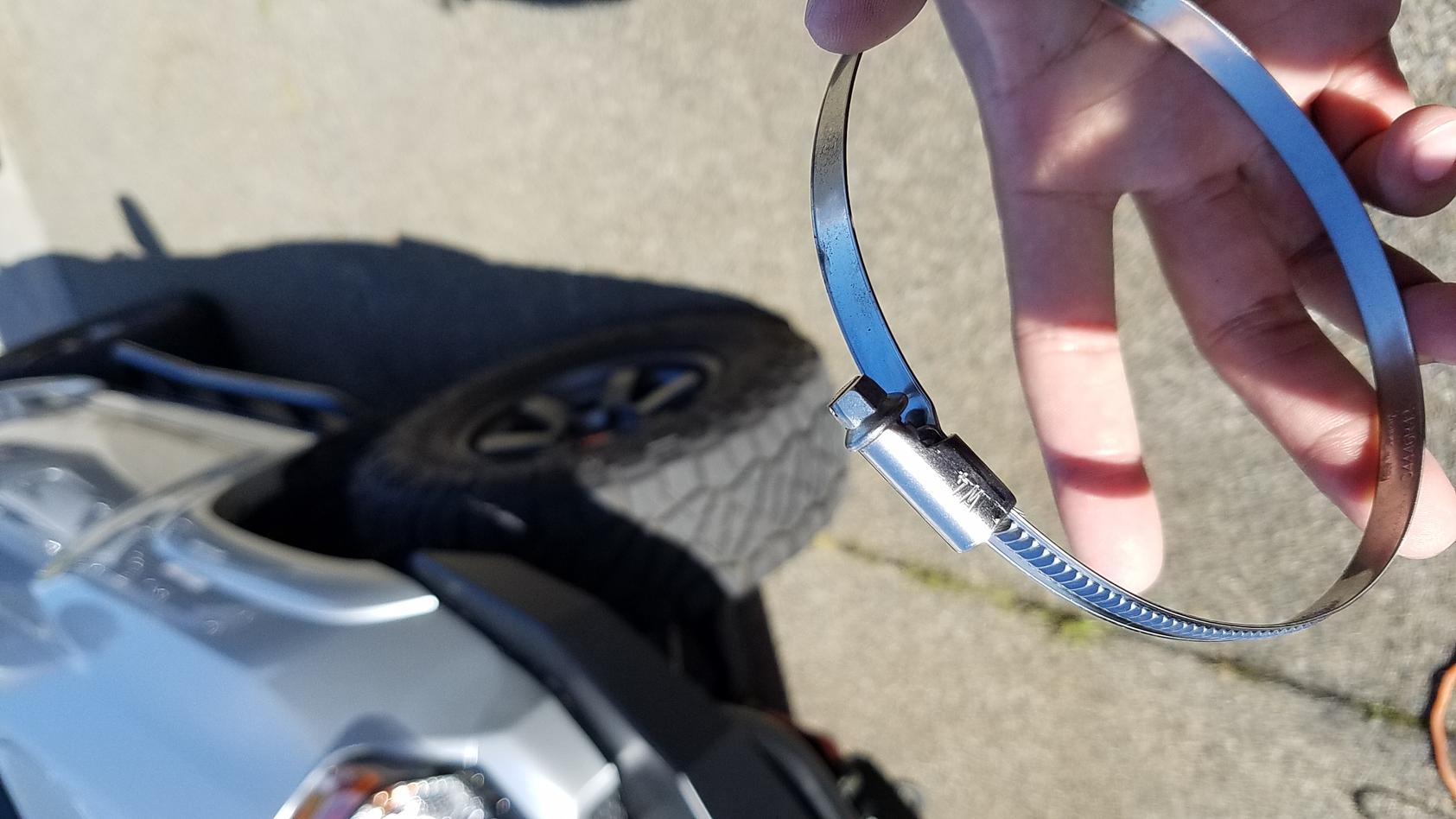

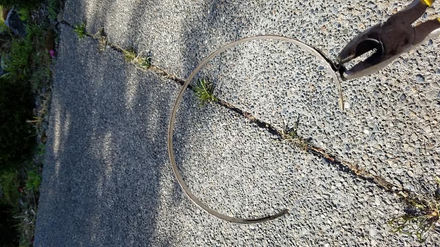

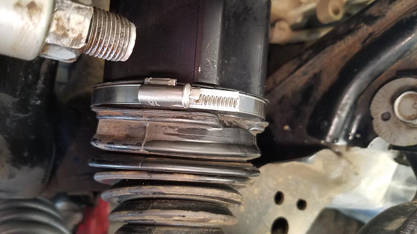

Replaced with a PFRAN worm clamp. Had to trim off some excess band after tightening them. Drove around and found no seepage. Only time will tell...
