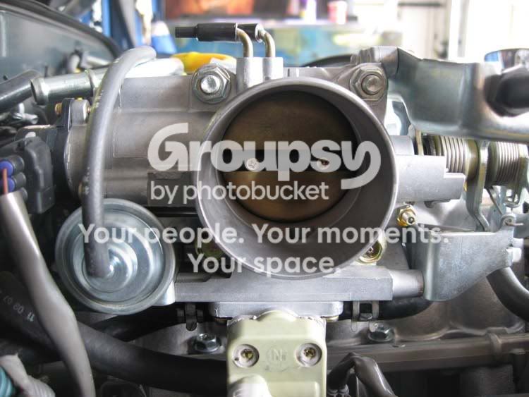

Which one are you talking about?

The round thing left and down from throttle tube. My hose was sitting on the metal nipple, but not pushed on. It gave me 1300 rpm idle for two months after a TB clean before I found it. Like I said, probably not your case.
In my defense, the two months were January and February and it was just too darn cold to spend the time chasing a fast idle in an unheated garage.

Oh, yeah, mine is hooked up. I bet that drove you crazy!! And yeah, I know what you mean about messing with it in the cold. I was outside with mine the other night doing all of this. I messed around with it til about midnight and it was 14 degrees when I finally gave up and went in the house!
