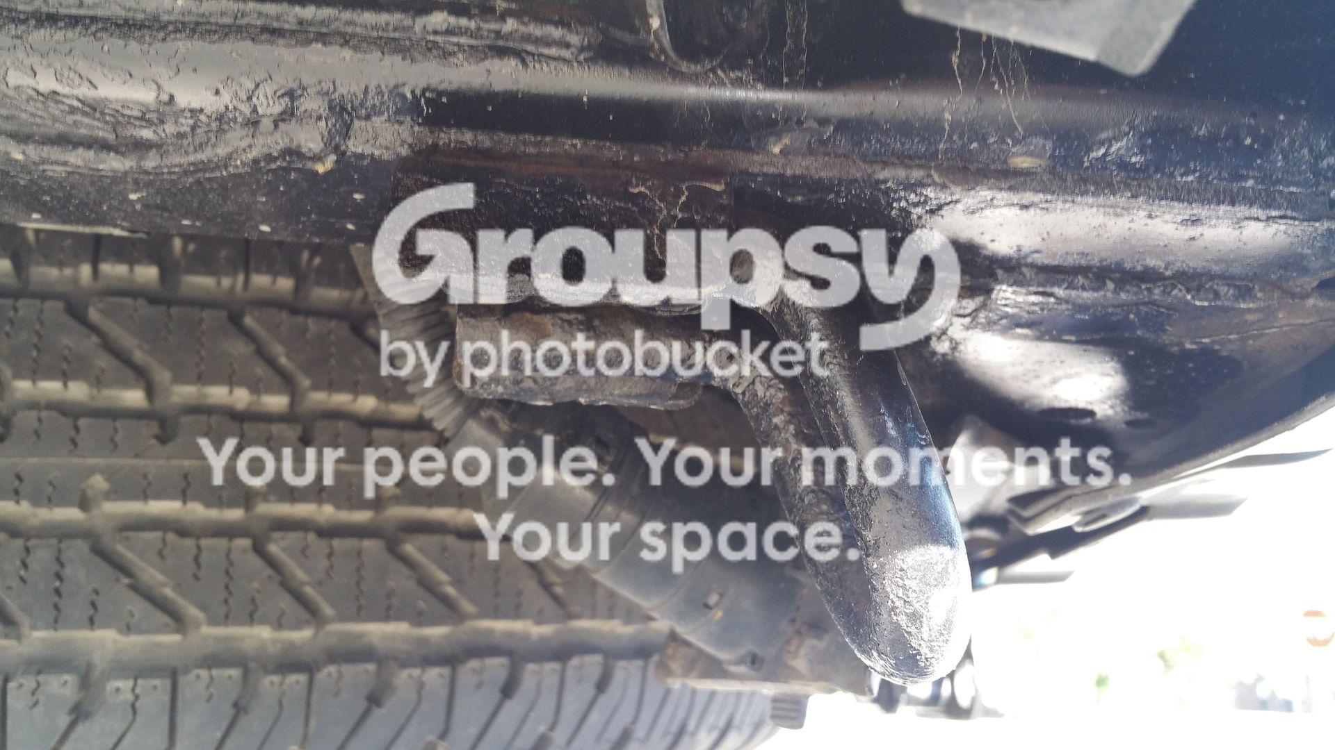

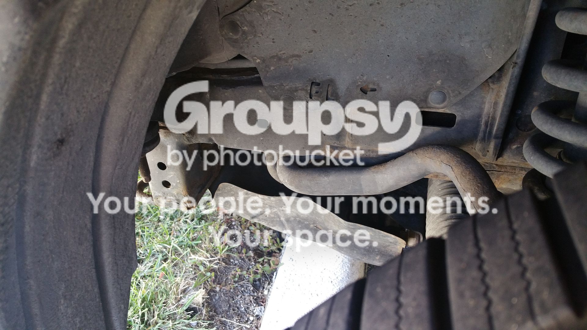

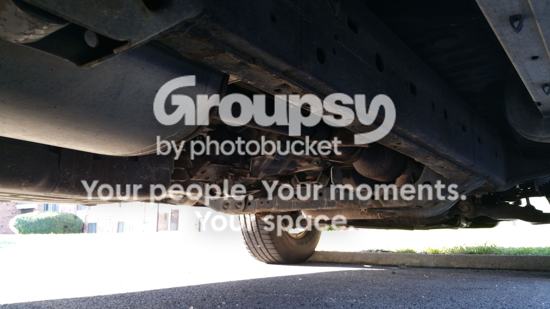

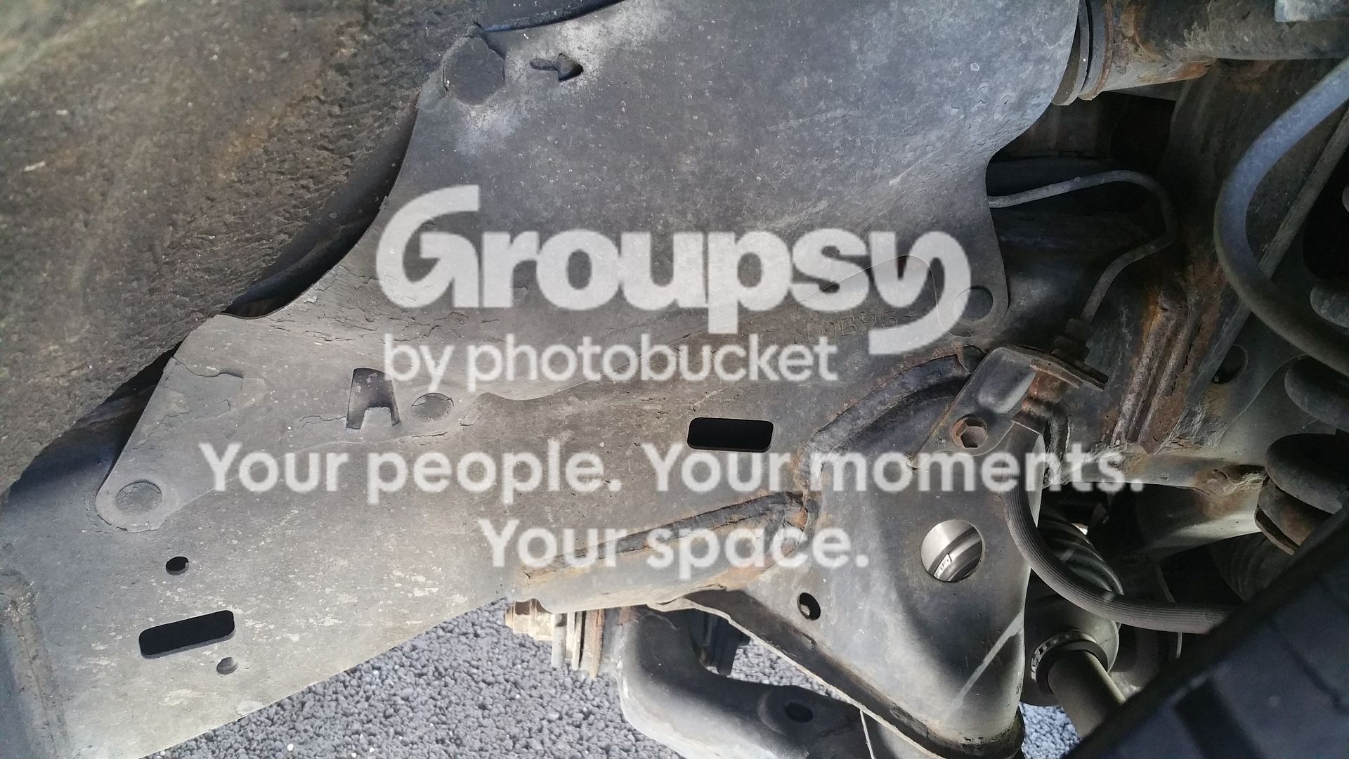

Here are some pictures:
20150915_121647.jpg~original
20150915_121634.jpg~original
20150915_121622.jpg~original
I guess compared to what some cars look like in the rust belt after 13 years, I think its in excellent or at least very good condition but definitely some noticeable rust.
Is there any body who does professional Por 15 jobs?
To me, that looks like excellent condition for a 13 year old truck from Ohio...
I wouldn't touch it if I were you. Just forget about it.
13 year old vehicle in the salty rustbelt of the midwest and your undercairrage looks like that. Unless they dressed it up and tried cleaning it up a bit and sealing over it. Your frame looks amazingly fine. Party on :whoo:
As stated - doesn't look too bad all. You could always prep and por15 or similar, or fluid film are the suggestions you'll get around here. Either way, carry on.
heck mine is a california truck and looks like that i think you are good...
If it really worries you take a wire wheel or brush the the rust areas and then paint it with a decent rust inhibitor primer and black paint and call it good.
Such a relief to hear, I might still POR it jsut so I never have to worry about it but I'm so happy thats its GTG, and now I have the greenlight to go mod crazy!!

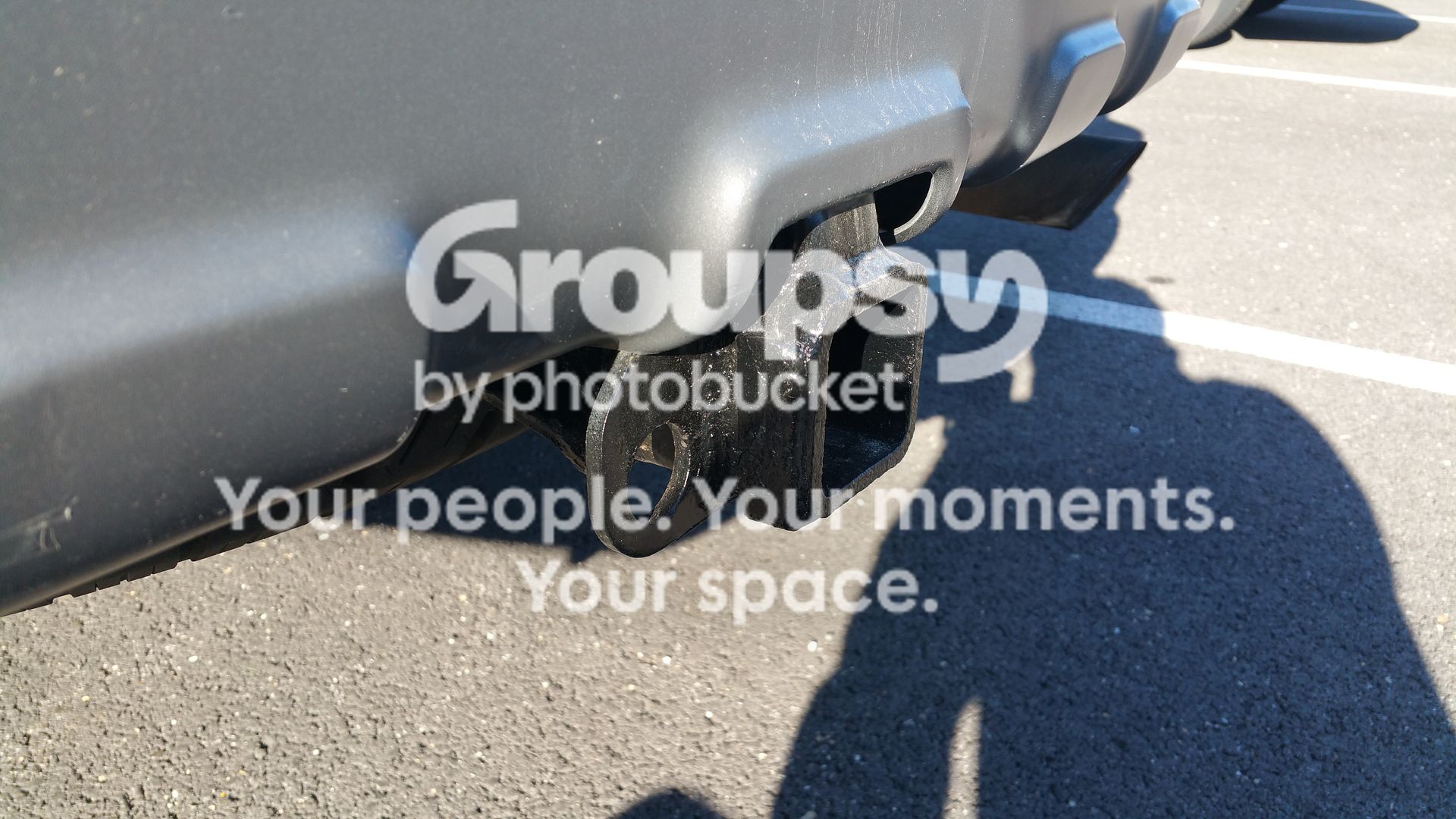

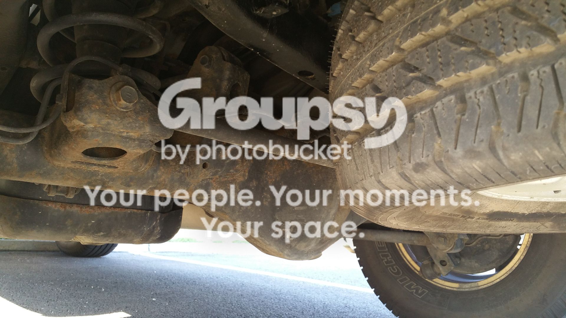

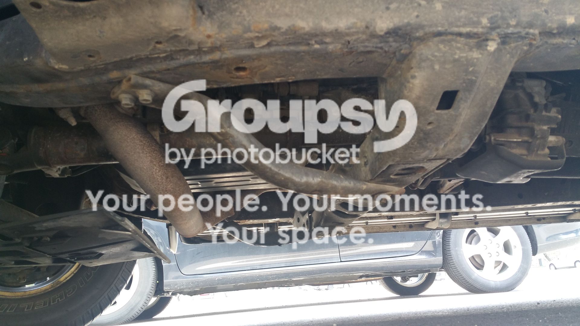

Here are some more pics for good measure (I did a little paint touch up around the spare and on the hitch):
20150915_165357.jpg~original
20150915_165409.jpg~original
20150915_165419.jpg~original
20150915_165519.jpg~original
20150915_165531.jpg~original
your 4runner looks great underneath in my opinion. my wife's 07 looked a hell of a lot worse than that before I put on two coats of POR-15 earlier this summer, now it looks brand new.
POR-15 is a great product. tedious and hell to apply and like anything else surface prep is the key.
I tried fluid film before por-15 when it looked a little worse than yorus and after two years it made it worse in my opinion. by worse, I mean it accelerated the surface rust by causing the oem coating to peel flake faster than it otherwise would or had. that's why I por-15'd hers this summer.
I believe por-15 is a great product to keep something looking new but probably not the best option if you have existing surface rust, at least this is my experience.
