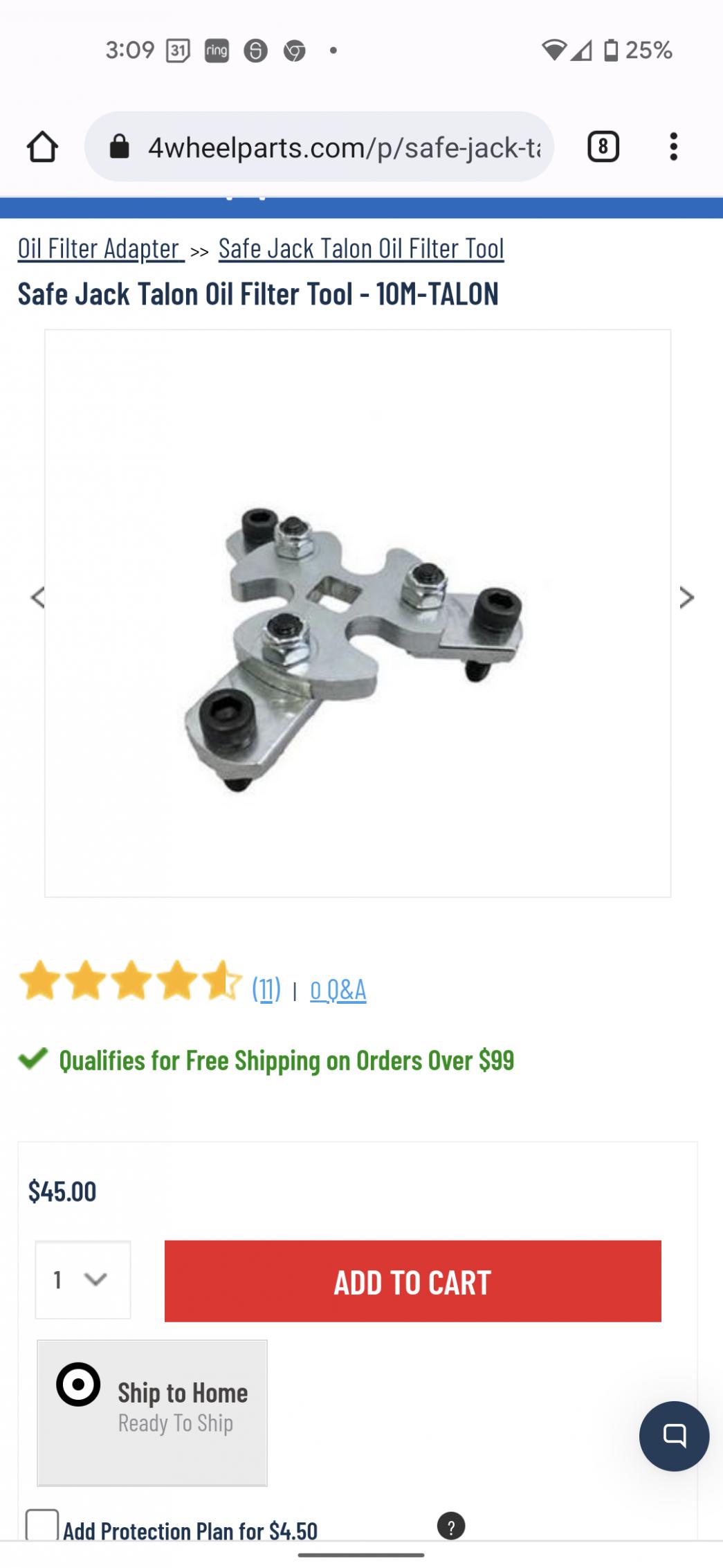

Finally I bought this Safe Jack Talon Oil Filter Removal tool. Little pricy but realized only way to get a grip on the holes inside the oil free to turn it. It had a few different width bolts so I changed out to the once that fit.
10 mins later the damn thing turned. What a nightmare!

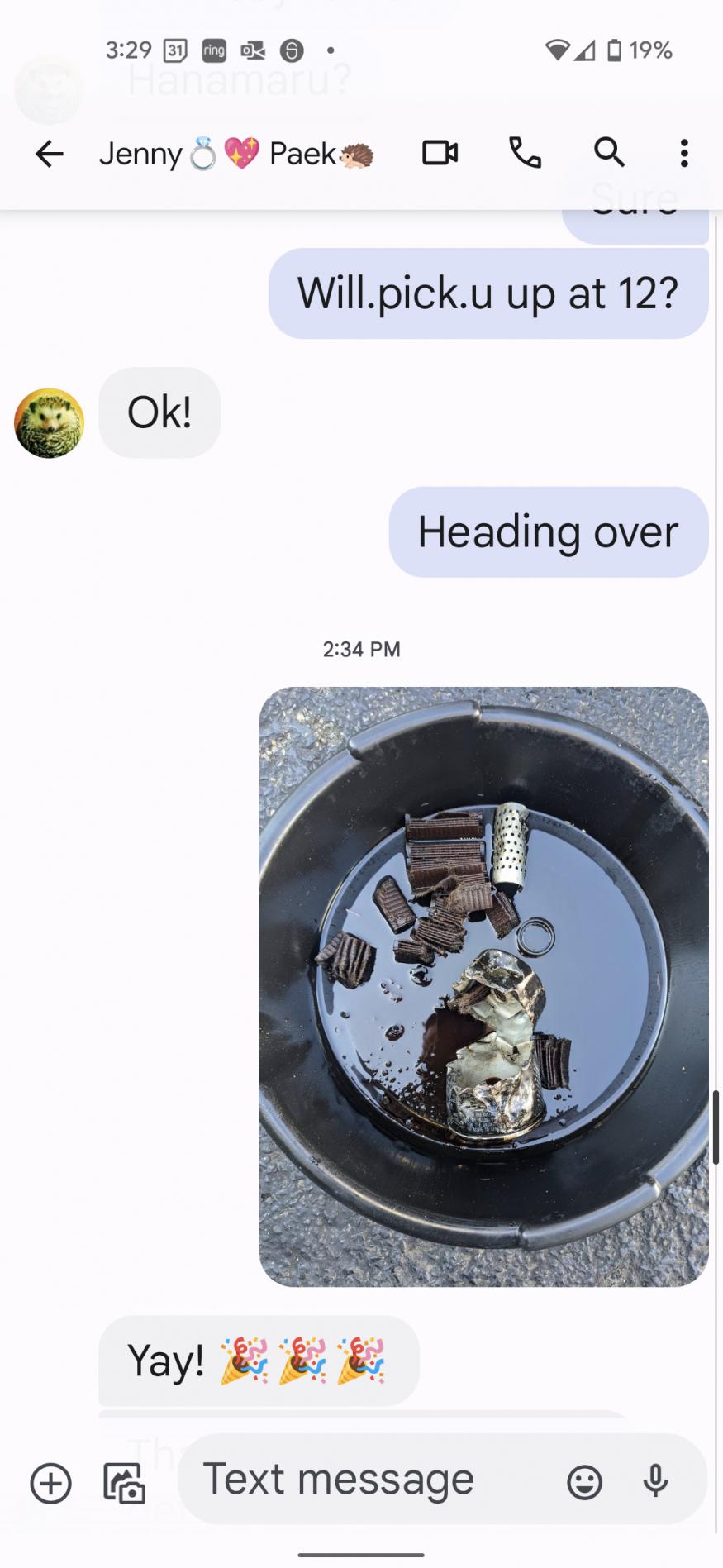

Couldn't attach pic from my phone for.sime reason. But here is the aftermath.
