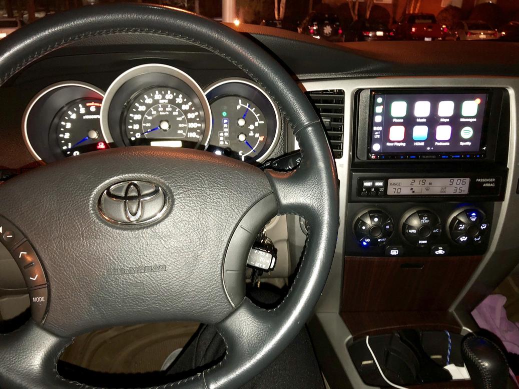

Hey I got the pictures and info for the heated seat install and will post it with the seat cover install. Also the deck is a kenwood excelon 9903s and it’s honestly great. It has Apple CarPlay, android auto, a capacitive touchscreen and a lot of other features. Would recommend it!
Yes, decks looks really good and cheaper than other options. Definitely looking forward to the install pics.

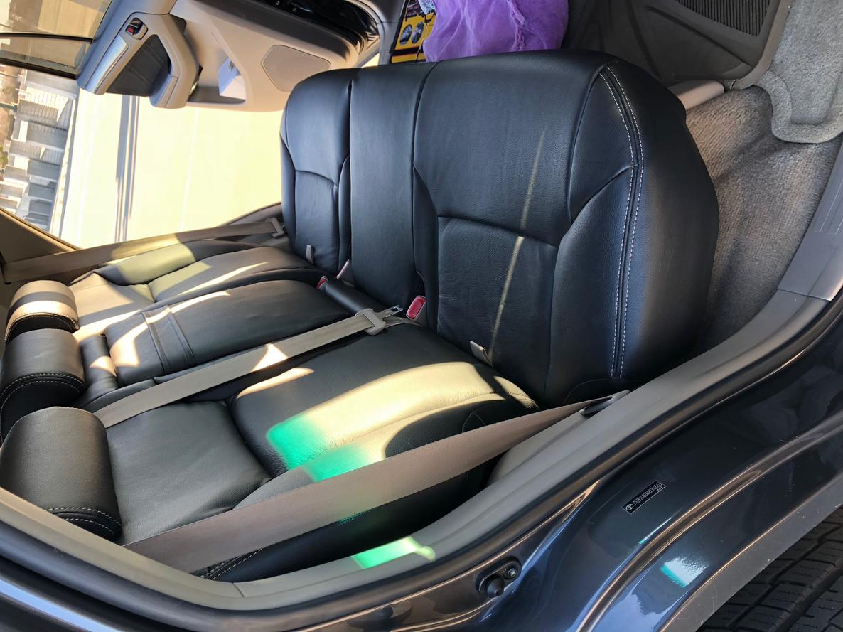

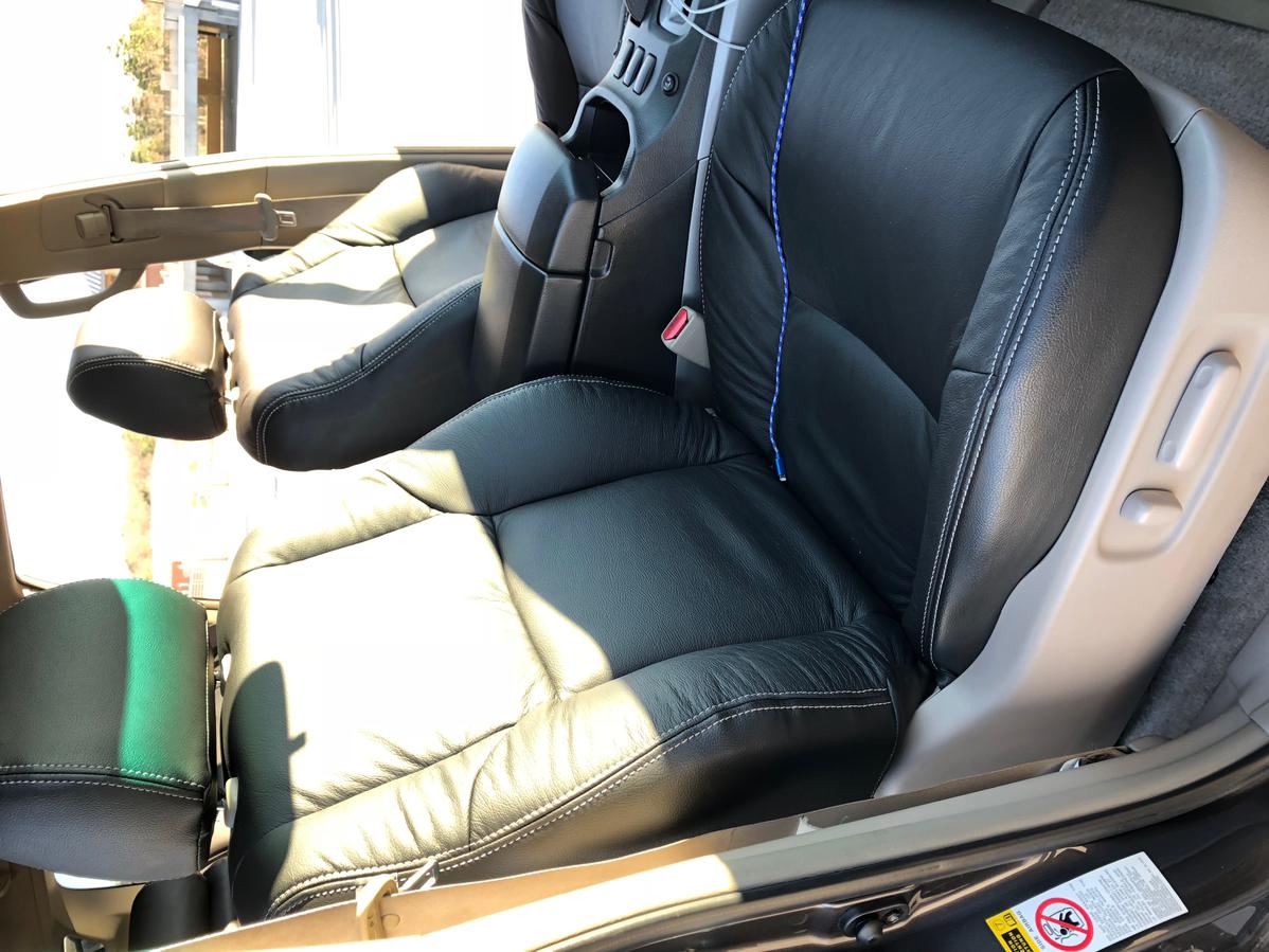

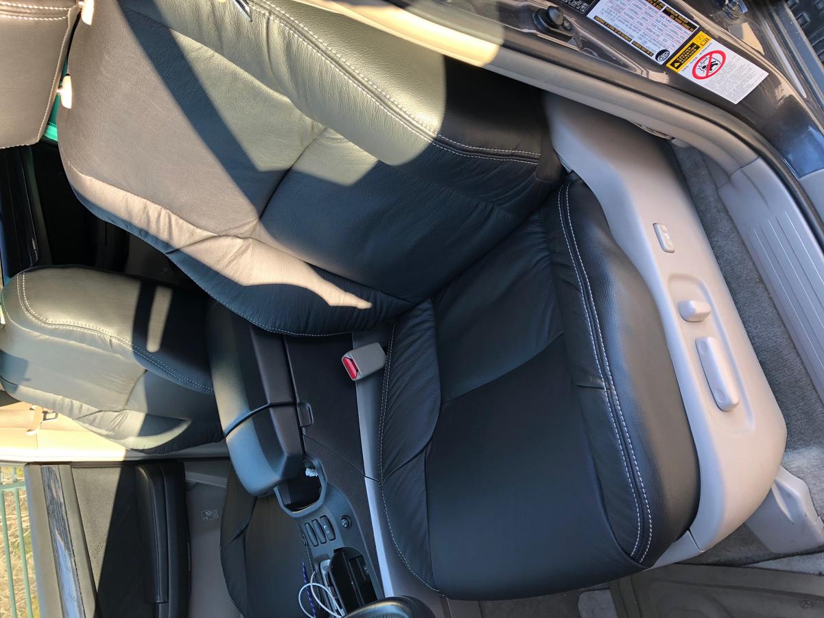

Here are some pictures of the final product. I did everything myself except I had some help from a friend getting the zipper on the front seats done. Overall I am very happy with the final result. I may later use a steamer to get the last few wrinkles out if the heat doesn't already do that. My recommendation is that you do it slowly as the more time you put in the better the final product will be. The hardest part is the large rear portion that has the armrest. I found that if I looped one of the metal rods from the old seat covers around the new rod and pulled it through the back that it allowed me to much more easily install the hog rings. Also a note that after doing this install your hands will be numb for a few days haha
Looks great! I'm not doing my rears as Im going a full delete of my seats. Any other tips/tricks for the fronts? Mine are ordered and will be here soon. My driver side is in bad condition so have to do the padding too. Could the wrinkles be from not being tight enough or not pulled around at the right angle and then hog tied?
Sent from my SM-G935V using Tapatalk
Thanks! And for the fronts, a few things to note: when you take off the old seat cover test fit the new one to be roughly where its going to sit then mark the top two hog ring points so that it goes on straight. Also be careful with the zippers. On the driver side I accidentally missed a few teeth which caused it to unzip from the top. It was relatively easy to fix (had to unzip the other side to zip it back up) but just be careful. On the lower portion the part of the cover in the front is suppose to clip into a metal rail. No matter how hard I tried I was unable to get it in there so instead I used hog rings. On the driver side I ended up adding a little foam which helped the fitment. As far as the wrinkles I think most of them I can get out by massaging the leather a little more and last resort would be to use a steamer. But the covers are on there very tight so I dont think them being loose is an issue.
Hope that helps!
Dude, that looks great! Thanks for coming back here and updating your thread. Can you tell a difference in the back between the leather and vinyl? Trying to figure out if the full leather is worth the extra 150 bucks.
Thanks!
and honestly I really can't. The grain of the true leather is ever so slightly more defined but the feel to me is pretty much the same. Also I found that the areas that are the vinyl material tended to not have any issues of wrinkling and were easier to get stretched onto brackets. Its really up to you whether it is worth it or not. Hope that helps!
Hope that helps!
