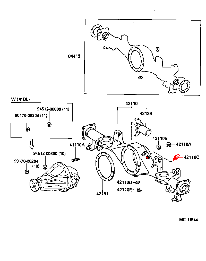

I have no idea. From this diagram, it looks to be near the top on the drivers side.
I believe thats your breather plug.. the picture was just at an awkward angle with the line bracket covering the fill plug... its usually in the rear facing side of the differential in the middle a bit to the right.
part 42110a
part 42110a
You're right with that being the breather plug as well as the angle of the picture. The back of our diffs have a hump that sticks out and combined with the angle and the ebrake bracket, it's just hiding.

Apparently a clogged breather causes pressure to build up, which blows out the pinion seal, so both should be replaced at the same time.
Obvious question: Where is the "pressure" coming from in a differential?
Another question: Is the breather the part highlighted in red in the previous diagram?

Looking at the Toyota parts diagrams, there's nothing called a pinion seal:
Q2: Is the pinion seal this part highlighted in red below?
41201C, 9031138047, SEAL TYPE T OIL
"Apparently a clogged breather causes pressure to build up, which blows out the pinion seal, so both should be replaced at the same time.
Another question: Is the breather the part highlighted in red in the previous diagram?"
The diff pressure builds up under heavy loads. That could be towing, really hot days and lots of cargo or some off road situations. That's why the breather is installed. It allows the air in the top half of the diff to expand and escape. People will extend that breather to prevent water from entering during water crossing when the hot diff hits cool water and the air is sucked in.
The red part is the diff breather.
Thanks for the confirmation. What I should do is buy a pinion seal, and remove and replace the breather valve.
