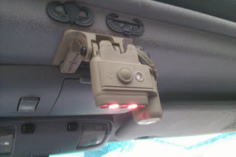

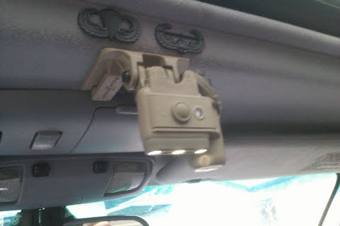

heres a cool mod i did using my surefire helmet light and the molle clip. i wanted a better map light and or adjustable light and then it hit me... 10.jpg
i just used two automotive trim screws and screwed them into the head liner, the molle clip will slid right out if you pull it, but its secure enough it wont fall out. i love the light cause i can have red or white light in varried brightness and can adjust where it shines..., i also did the molle seat covers- http://www.toyota-4runner.org/3rd-gen-t4rs/81627-molle-seat-covers-j-p.html
