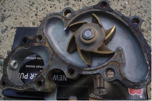

Anyway I open the top of TB cover, and surprised the belt looked almost new and nothing was wet there. Only after I dismantled everything that I can see it's the water pump leaking (wet weep hole, and gasket seems to be gone too).

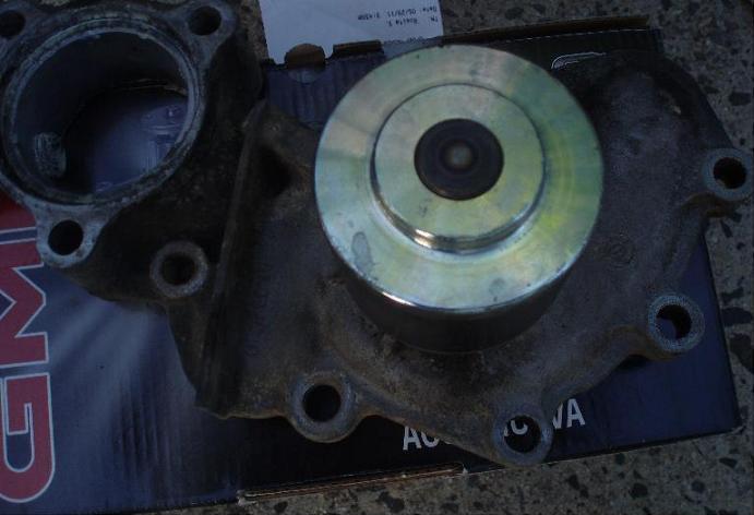

The old water pump has few markings (not OEM). I'll see if I can upload a pic so someone might be able to id it.
