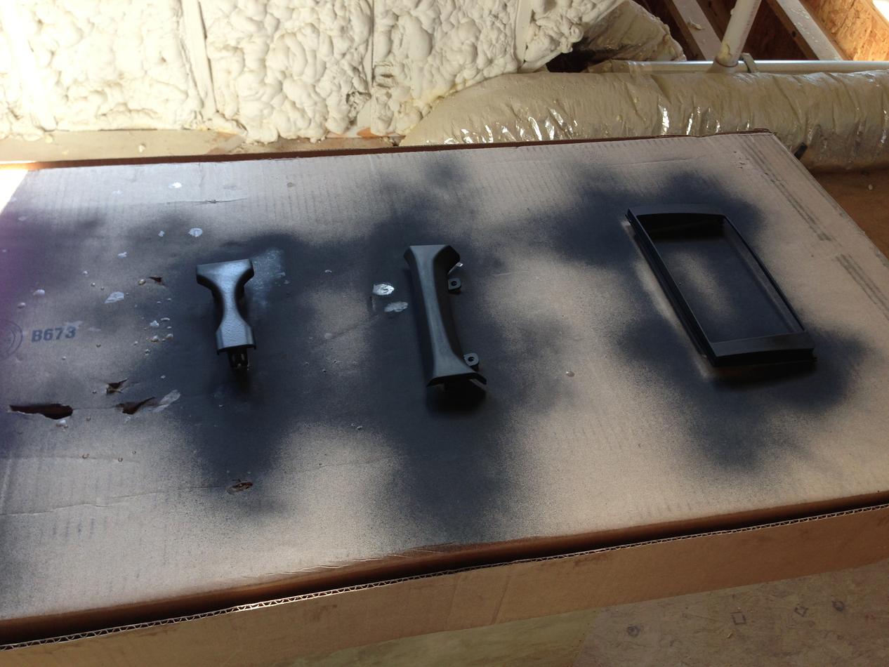

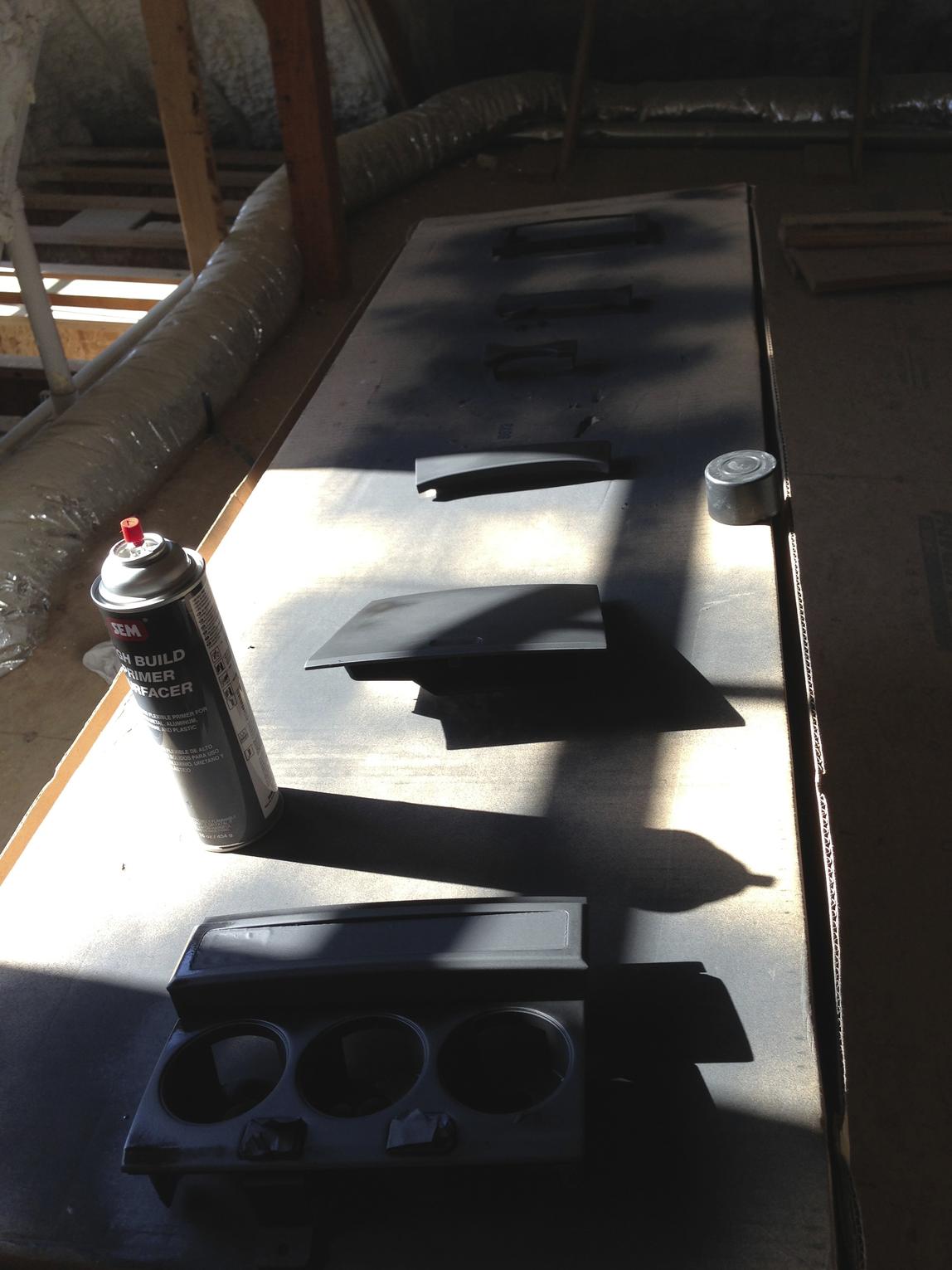

Alternatively, you can paint them. I converted my sport to have a JBL bezel and I ended up buying a silver HVAC module off ebay. I tried the DI-NoC on the pieces but wasn't happy with the result. I ended up taking all the center pieces out and giving them a matching coat of paint. SEM (i buy it from Levine Auto Parts) has a good selection of interior flexible vinyl/plastic paint designed for car parts. The end result looks almost factory.
Just take your time, get the matching SEM plastic primer, light-sand between dry coats.
