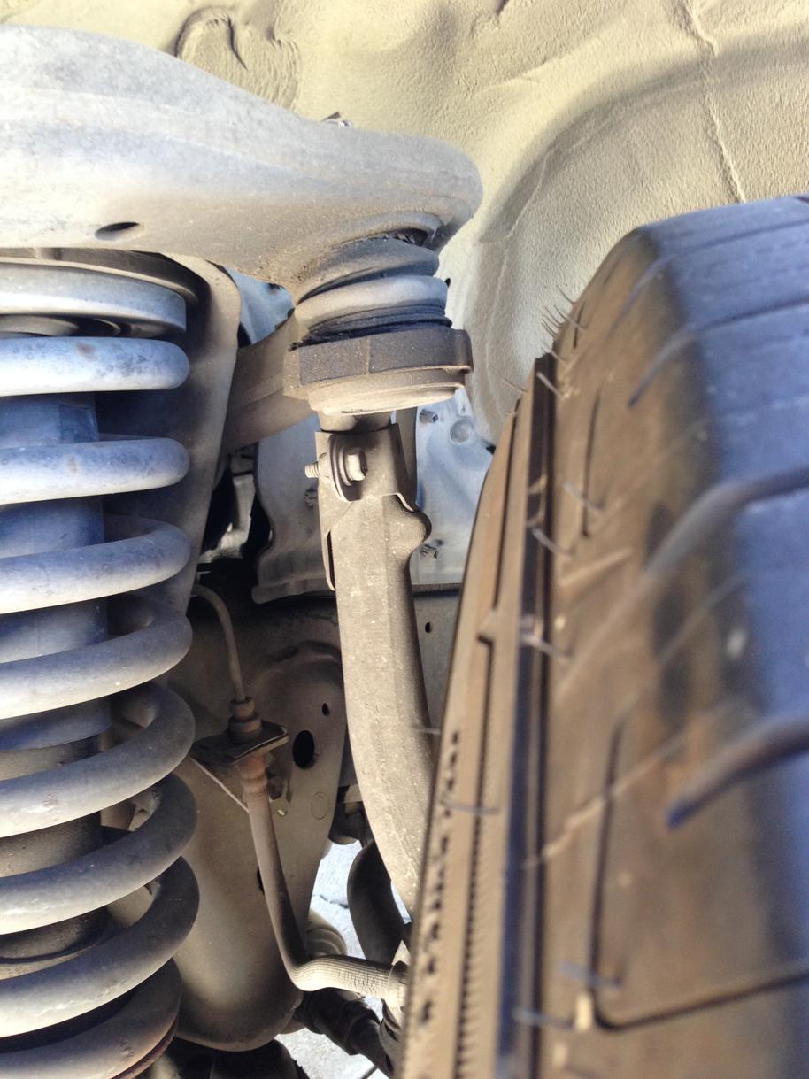

Grabbed a quick pic showing my possible backspacing issue:
The tire is a 245/75, so ~30.5" tall, a 265/75 moves the the wide point about 1/2" up (half the diameter gain) and 1/2" (half of the width increase) over towards the control arm/balljoint... Seems like it's getting awfully close. May try a set of 235/85 ta ko, a little taller and should clear without issue. I kinda dig the pizza cutter look anyway.

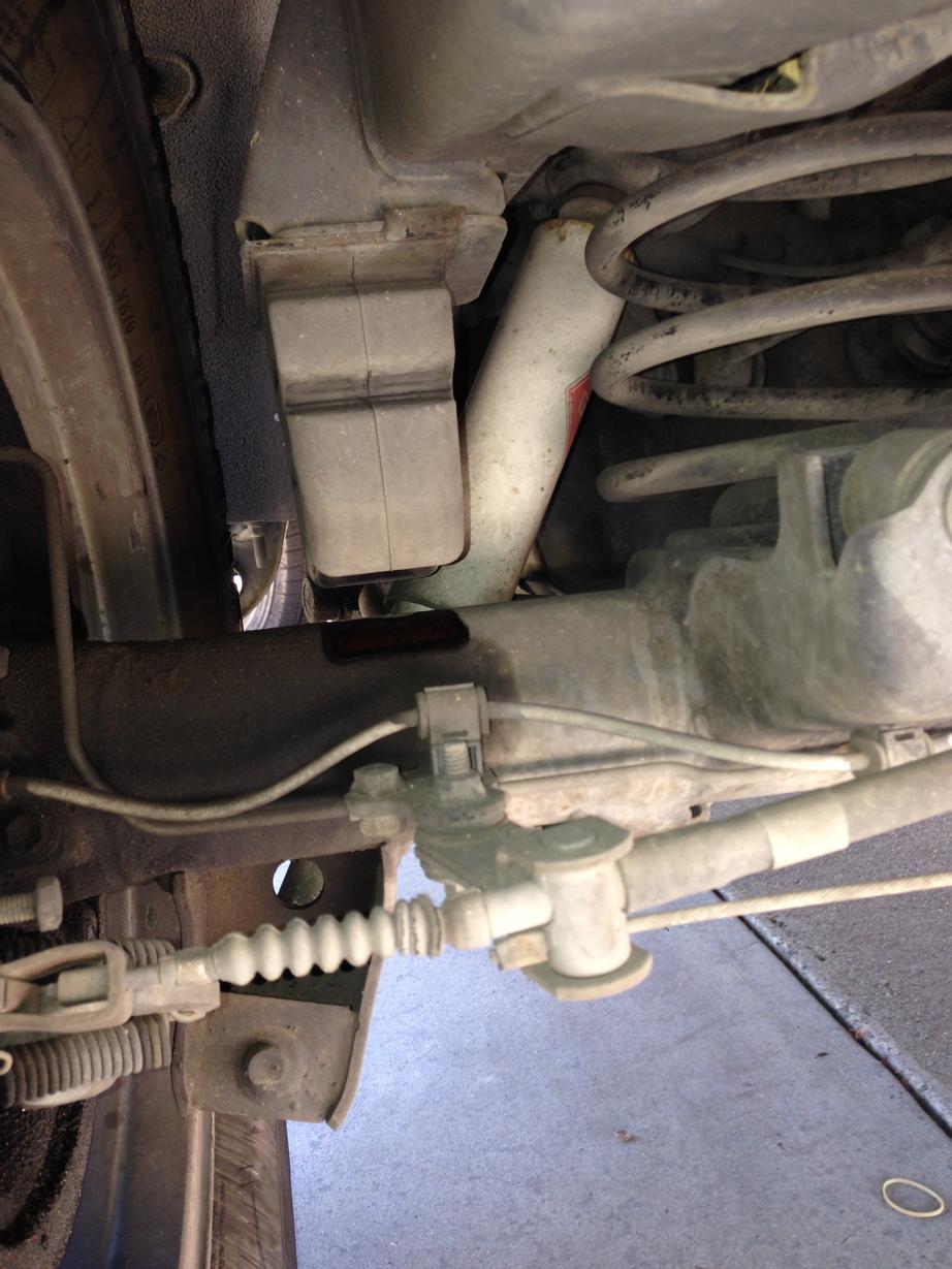

Another showing why I went with the suspension first:
She's very nearly ridding on the bump stops. Really harsh, but on the plus side there's almost no body roll! Also shows how bad the left axle seal is.

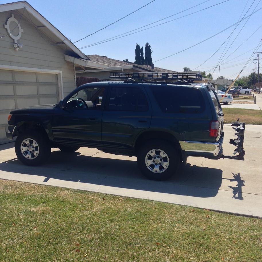

Progress!

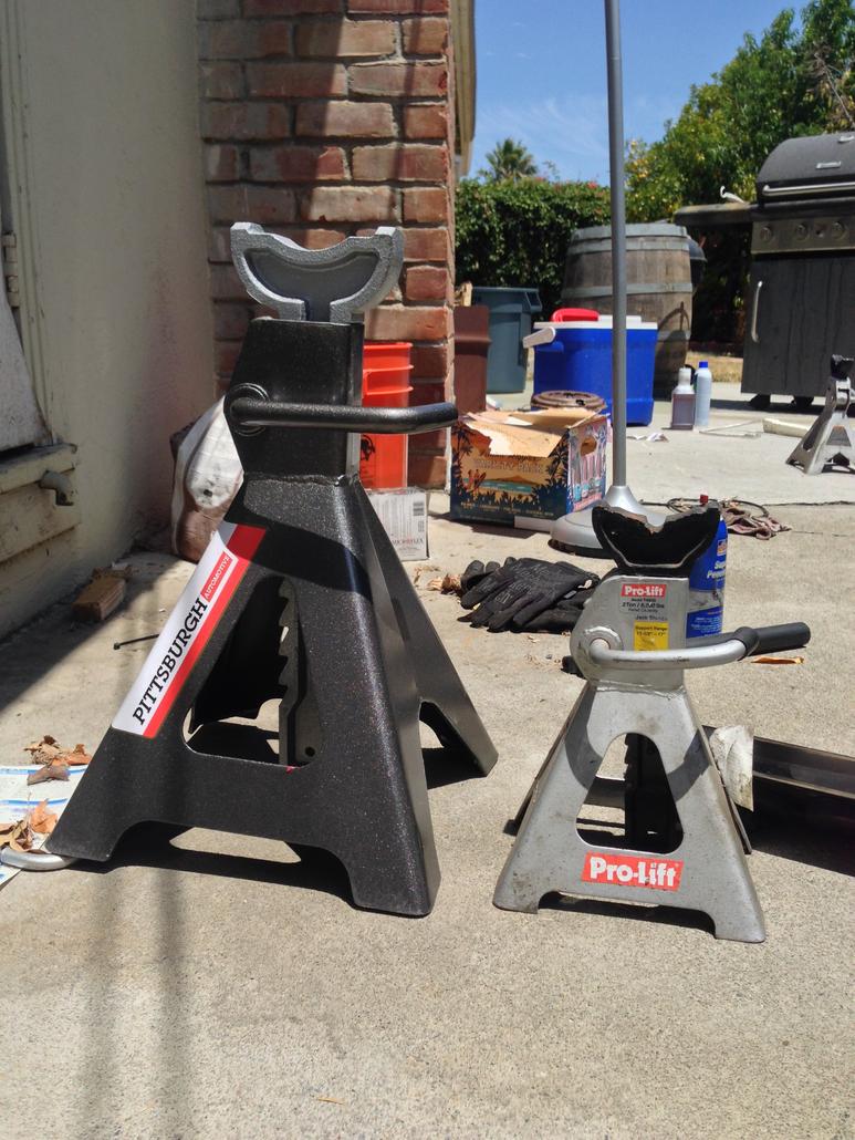

Got taller jackstands:

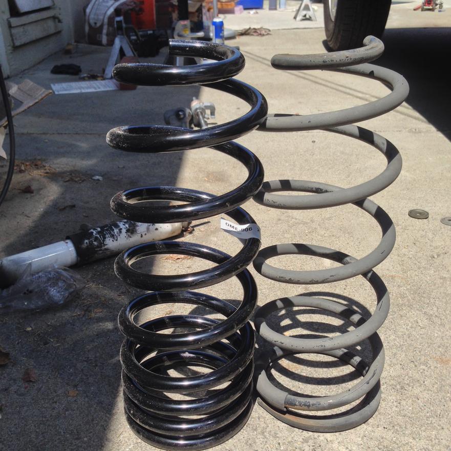

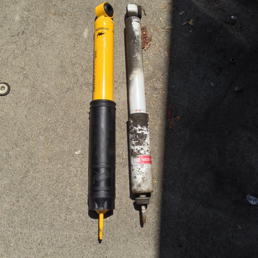

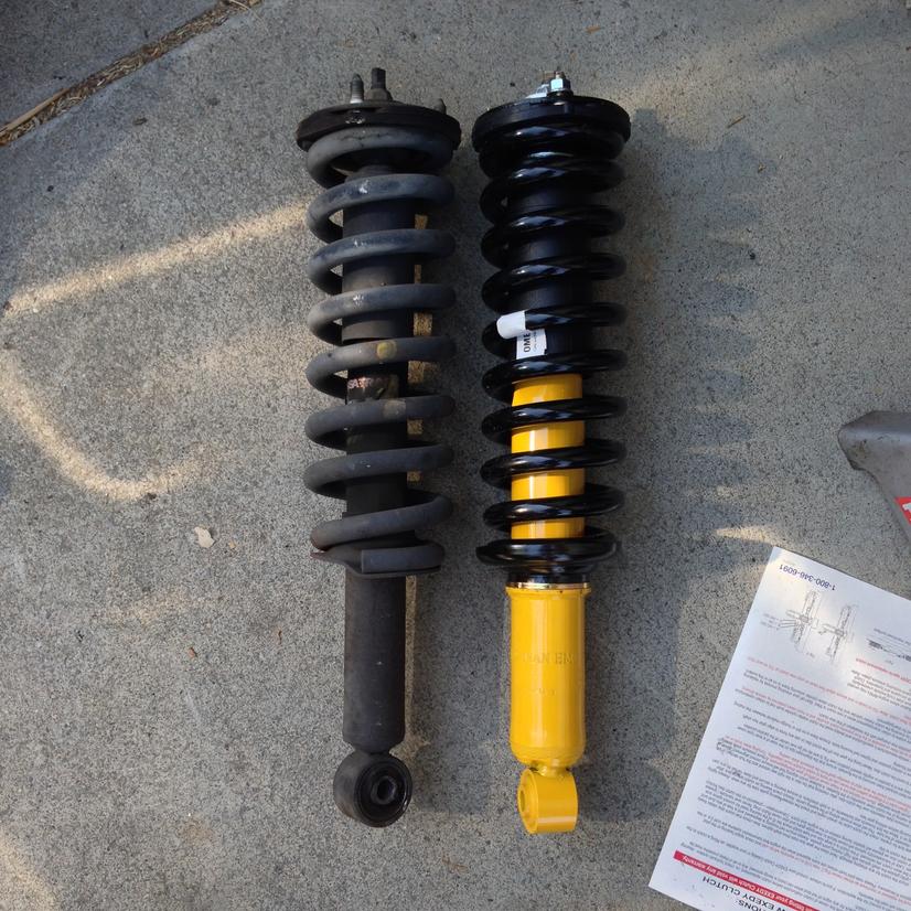

Used said jackstands to get the old junk out and the new OME goodies installed:

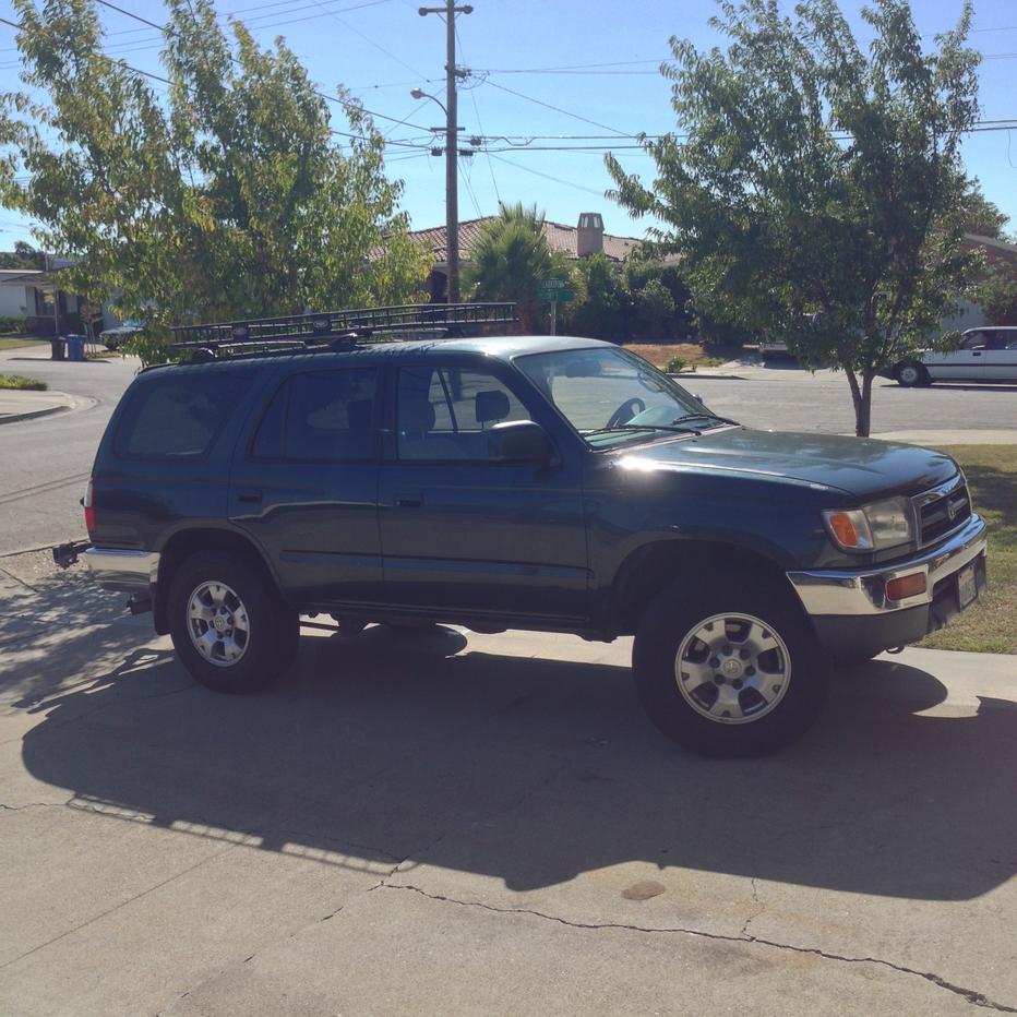

How she sits presently:
I'm really happy with the ride, but anything would be a massive improvement over the blown out and sagged stuff that was on it. The shocks were toast, and the rear would slam into the bump stops at the slightest hint of an impact.

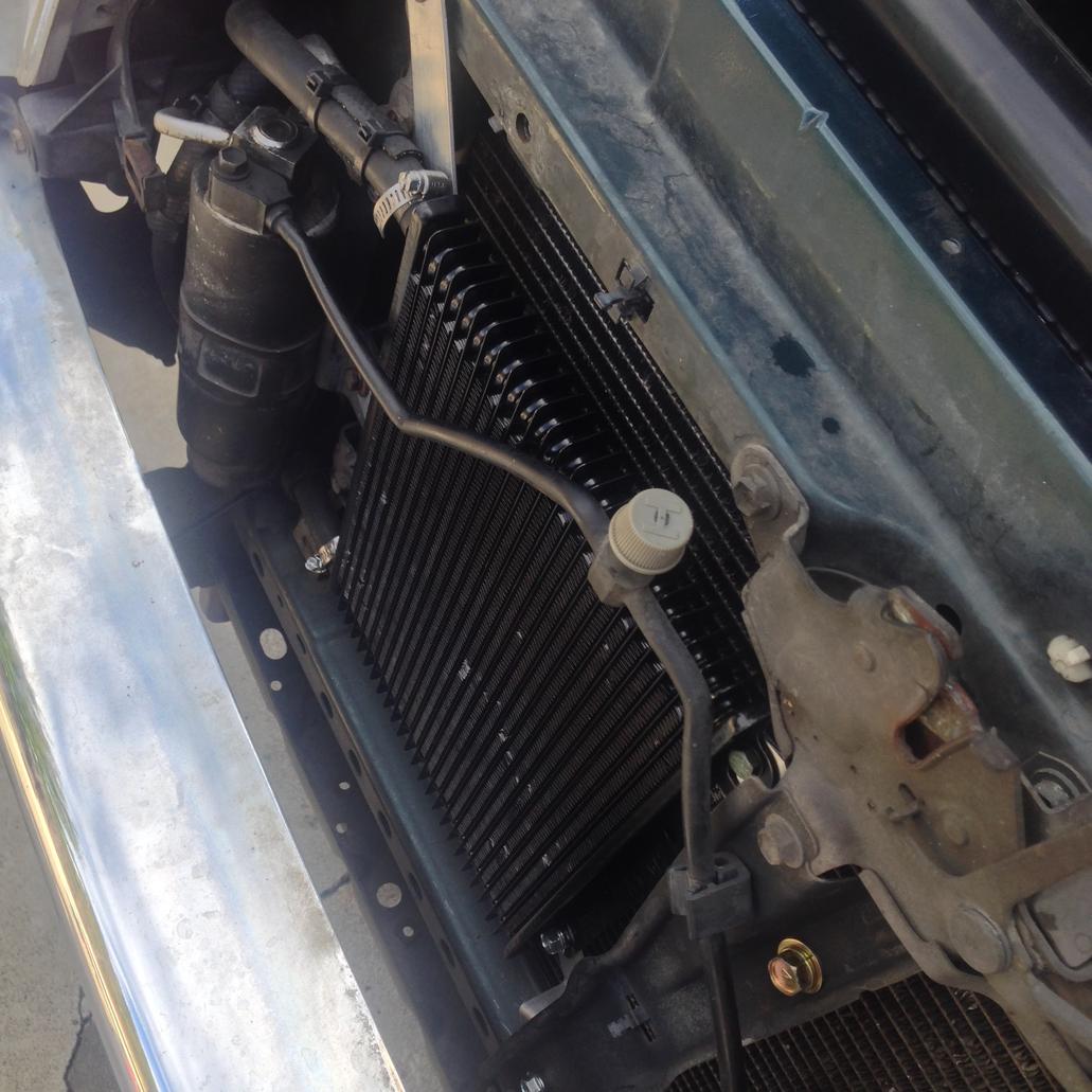

Also got the trans cooler and a new radiator installed:
It's a Hayden 678, supposedly a the same part as the TRD unit. At least according to the internet, I'm taking that with a grain of salt. Either way, it seems like a quality part and I got it for $36 from Oreilly's. I'd initially installed it with the zip ties that came in the kit, but decided to remount it with some brackets I hacked up from aluminum strip.

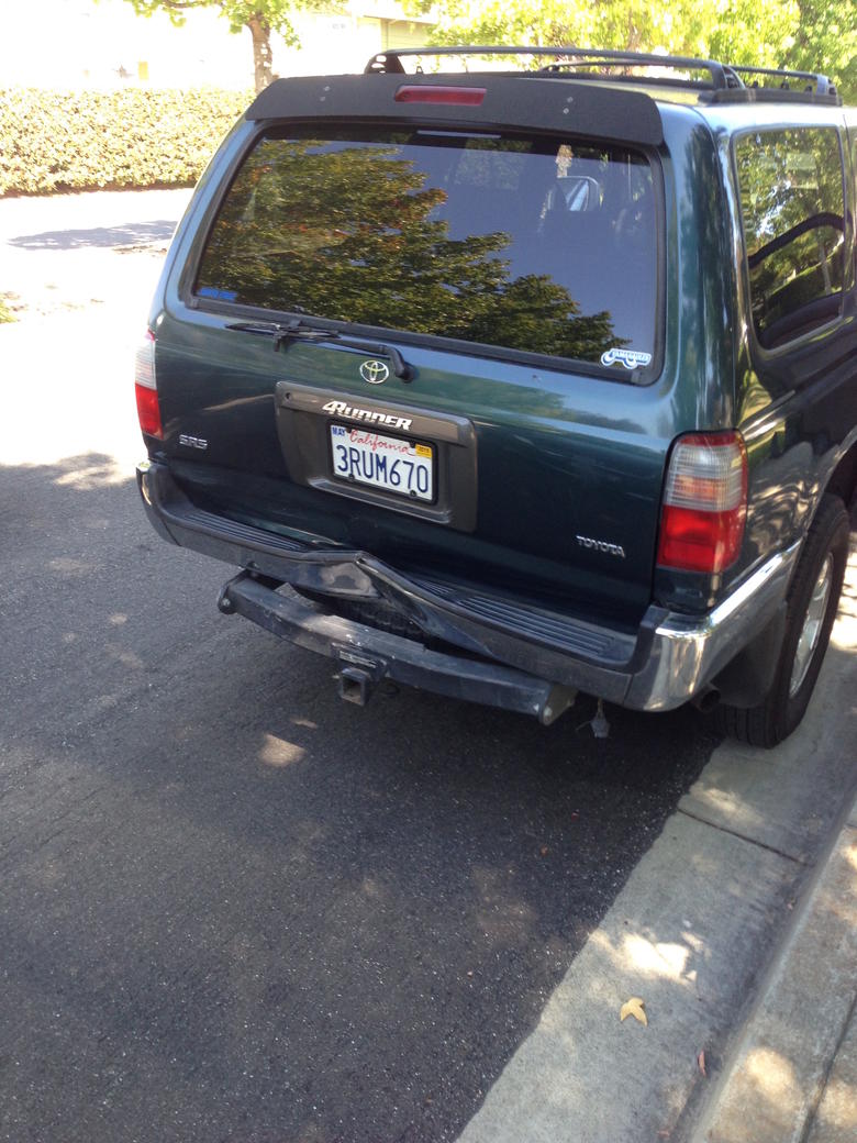

Truck was rear ended while I was headed to the tire shop, a kid in a Camry hit an Accord and shoved it into me at a light. Damage was fairly light, but it ripped the seat right out of the floor pan so the insurance company totaled it. On the bright side, I got a sweet rental for the weekend and they wrote me a check for $1500 more than I paid for the truck, including the $225 they charged me to keep it! A couple of bucks in parts (literally, just a few screws!), lots persuasion-by-hammer, some swearing, and some time at the DMV and I now have a truck that I am being paid to drive :cheers: She's a bit uglier, but you can't beat the price!
Only pic I bothered to grab of the damage, apparently:

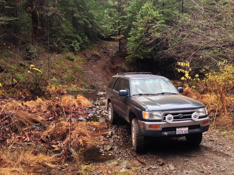

Here's pic from this weekend, with the new skinny tires and a pair of fogs:
I'm still really happy with the OME suspension. It's a bit firmer than I'd like off pavement, but it's not a marshmallow over the road. It's a trade off I'm ok with.
