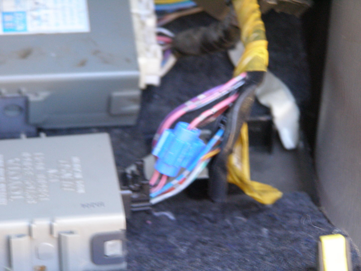

Ok, light came back on and I panicked, sh!t. So I removed the post.
I can conclude that this does work, as I moved the wire and the light came on, moved the wire again and the light went off. Good to go, just make sure you have a good connection.
PINK W/ BLACK STRIP AND BLACK W/ RED STRIP, CONNECT THEM TOGETHER.
Finally feel I contributed to this form and gave back to others that this form has done for me. :humble:
Wondering if you have any seatbelt issues?
Hi, I have the same module as you do and jumped the same wires. My seatbelt light no longer comes on or “dings” (not that I care much about that) but wondering if yours has the same issue? Thanks in advance!
