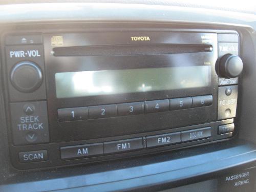

did you say the front just pops off!!
This is my radio
Dunk50 said:
This is my radio
You will have to remove it from the dash to remove the front panel and you will see that the plastic front panel (that whole black piece) is held in place by little metal bumps protruding through slots. Just carefully raise the little plastic tabs with a small screwdriver and work your way around it.
