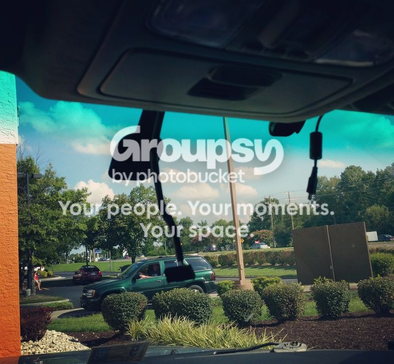

had this happen the other day. nothing like getting in the truck to go to lunch at work and see the mirror hanging

I guess I have that to look forward to since we live miles from each other and share the climate. At least you can go to Autozone and buy some 3M tape or glue for it. A simple but annoying repair. What was wrong with screwing the rear view mirror to the ceiling anyway?
