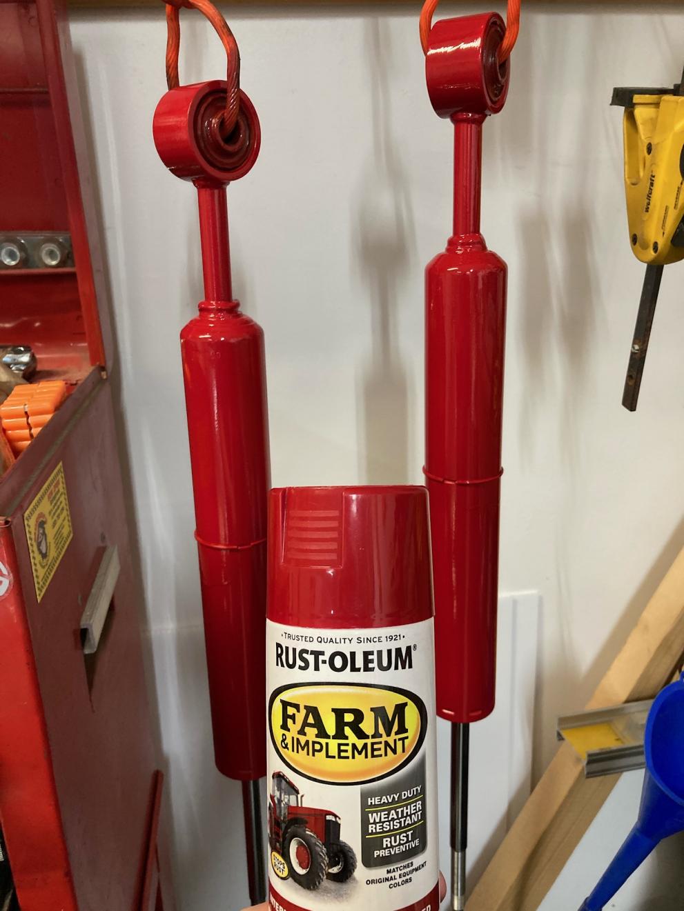

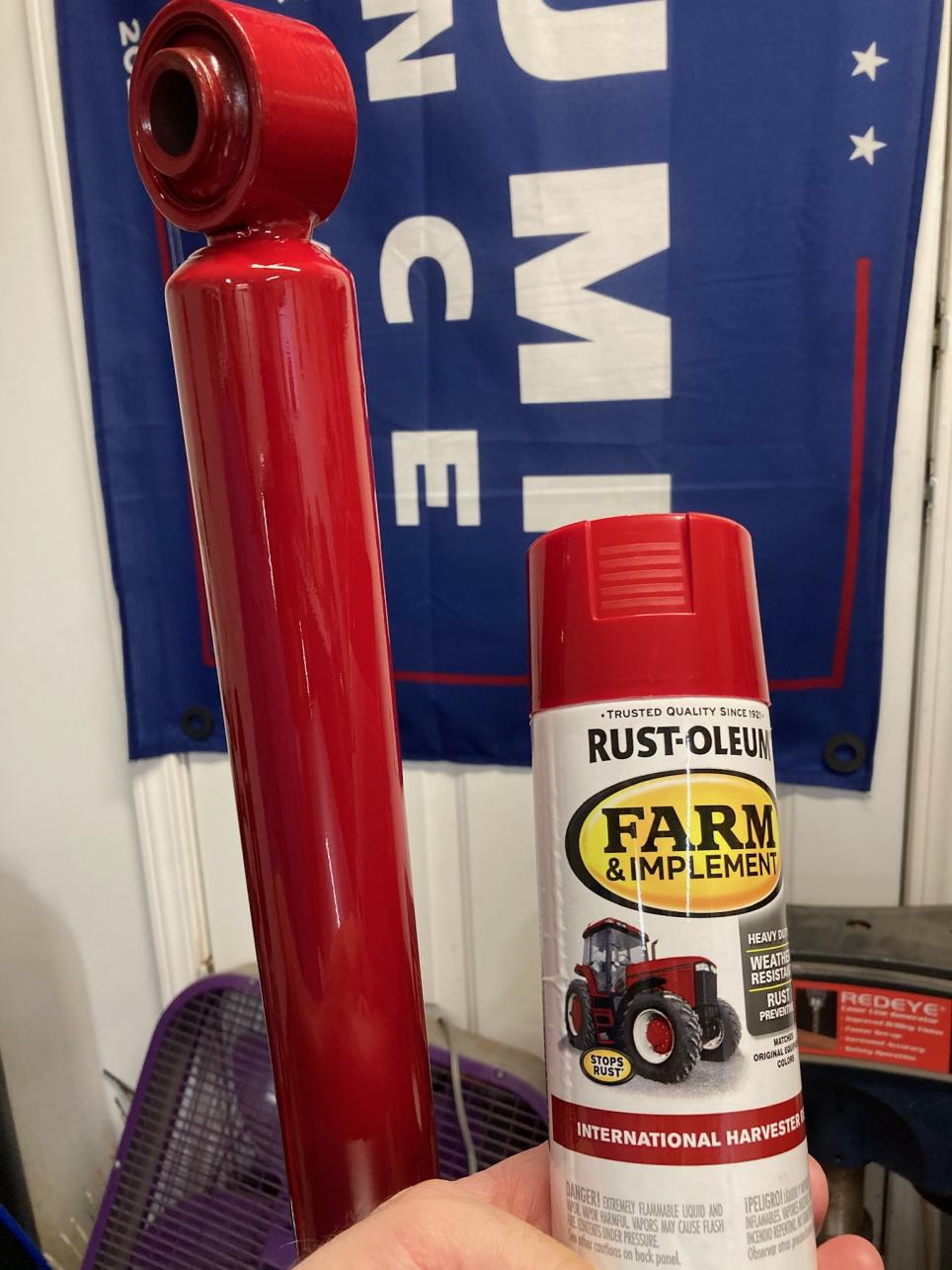

I am getting ready to replace my 222k mile XReas shocks with Bilsteins 4600. Im just not a fan of Yellow shocks. Its bling that falls flat. So with a little sandpaper and Red farm paint, They got a fresh new look before installing them. I just need to source one more rear shock.
Uh, what? You can’t even see the shocks when they’re new much less once there’s a month’s worth of mud & road grime on them. But to each their own, the red doesn’t look bad.
