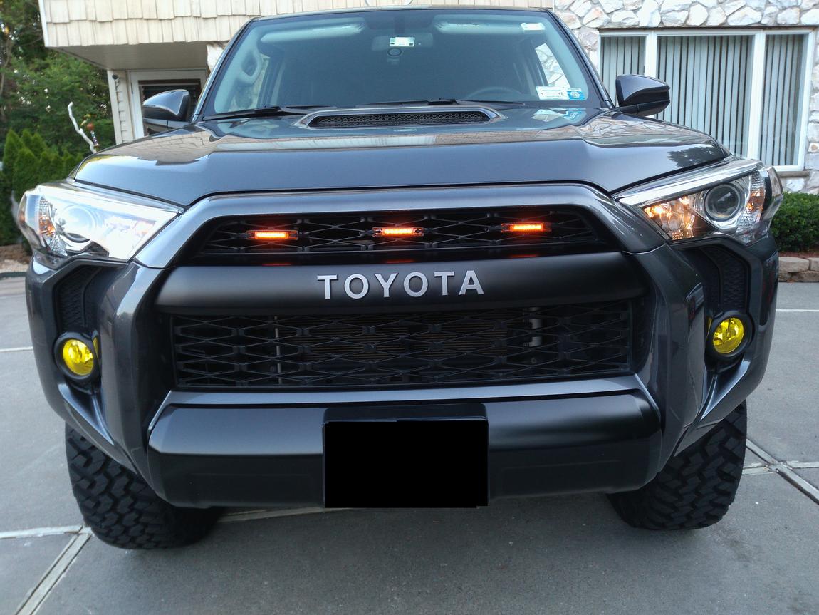

Later today I will be installing three amber LEDS to the front grill, I plan on running them parallel and tapping the DRL, then grounding the black wire to the chassis. I hope that’s correct.

Added the amber LED markers to the grill. Waiting for the amber fog light overlays to arrive.

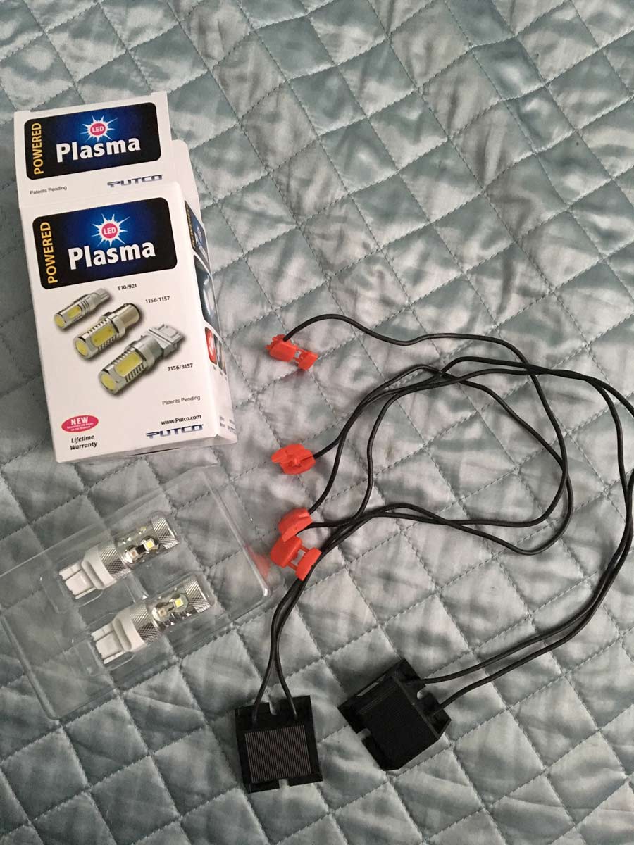

hey bikemedic ,like you I have LED's everywhere , the only thing that I didn't do is the front turn signals and front markers , I do have them and also the 11 ohm resistors (the whole thing from XenonDepot) but I did not install them yet ...it is difficult to access the bulbs and to install the resistors (they have to be screwed on metal because they get really hot) ....I am wondering if I should take off the front wheels and the plastic fender well cover to gain access to the area its very frustrating to say the least!
how did you do it?

Getting to the bulbs was not that bad, but tapping the resistors into the lines was. I made the connections better when I removed the front end to instal a hidden winch last weekend. If I had it to do over again and did not want to take the front end off I would remove the tires to gain better access.

Bikemedic thanks ....that's what I thought , it has to be easier with a nice open space without wheel and cover!!
