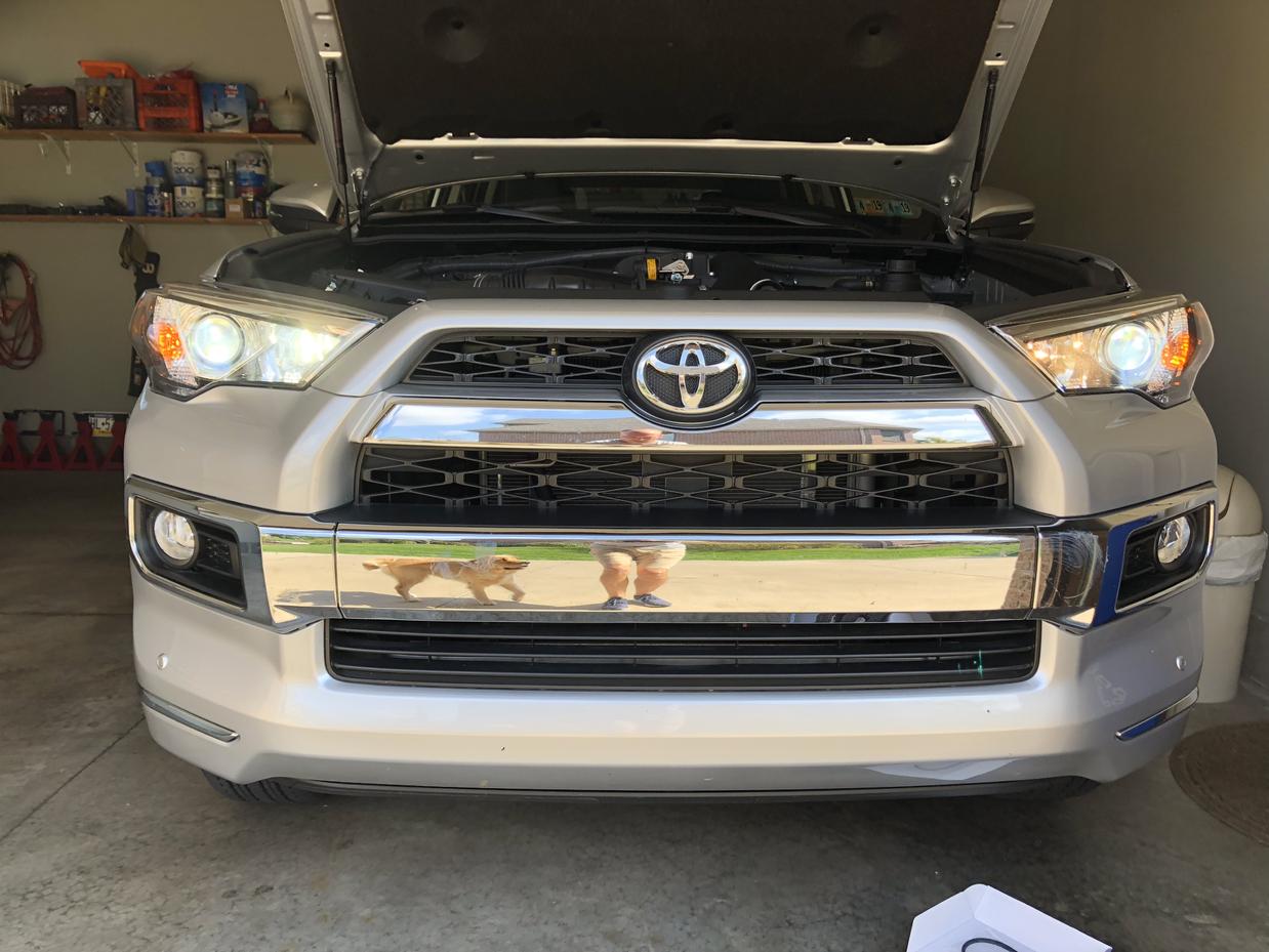

Installed. Pics have XenonDepot 9005 LED with DRL driver in driver side and Silverstar bulb in passenger side. My low beams are XenonDepot 5000k HID. Work very well. Look better than standard bulb.

Dang that looks pretty good, I did the same low beams.....I’m thinking I need to do these new high beams/drl drivers

I'll do it this weekend if someone doesn't do it before me. For color temp this is a comparison on stock HB and XD HB's. Like decade old tech on driver side...compared to new(er) tech on passenger side. I have DD LB HIDs 6K temp. The DRLs are the same temp, just lower intensity.
