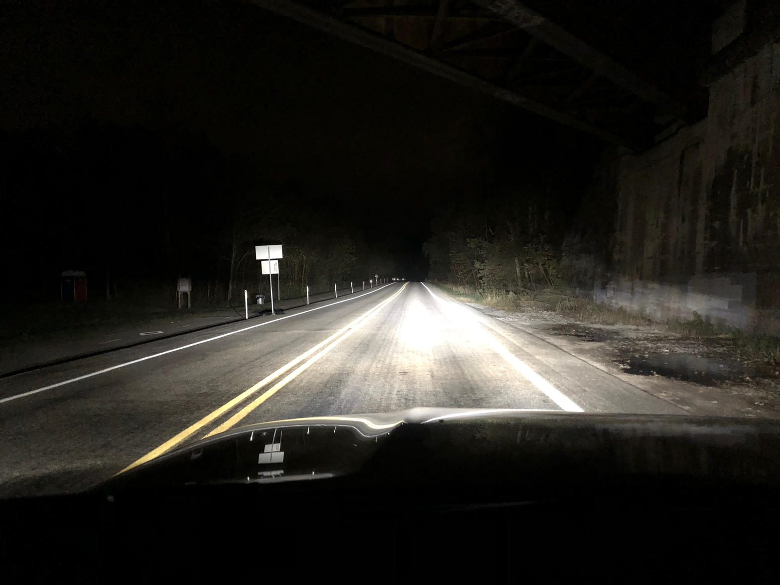

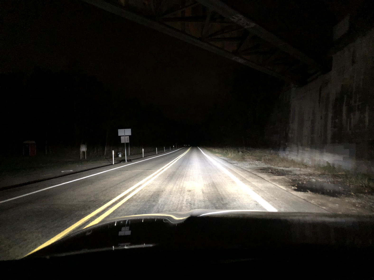

HB XD LED output
Finally got a chance (and remembered) to take a pic with and w/o LED HB.
My LB are DD HID 6Ks. You can't compared OEM LB with HIDs...not even close. HB also leave on the LB...so my output will not be the same if you have OEM LB.
LB first...then HB
