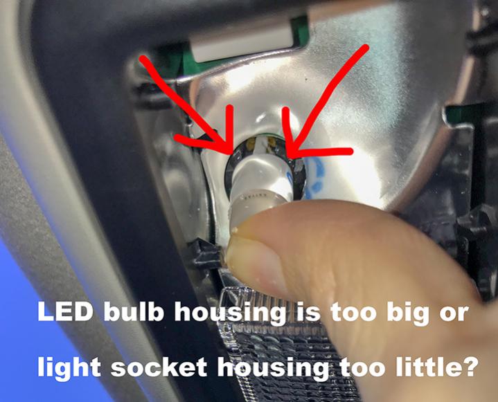

Help!
Hey [MENTION=12905]XenonDepot[/MENTION],
I need a little help here.
I ordered the interior light swap kit, and everything was going great until I got to the map lights and courtesy door lights.
The white part of the 194 LED bulb housing is too big to go in the sockets.
I wiggled, I jiggled, I pushed, I flipped (the bulb, not me... :nod:) to no avail. :(
I have a 2018 TRD Off Road Premium.
Pic below for map light. The original light went back in perfectly, I tried both of them 3x.
What do I do!?! Thanks!
This is very odd! our 194/T10 bulbs are designed to be a direct replacement for the OE units, and because of how common they are, we ship a ton of them.
That said, if you never got this to work, please feel free to reach out at [email protected] and we'll gladly exchange them or accept a return.
Sorry for the troubles!
