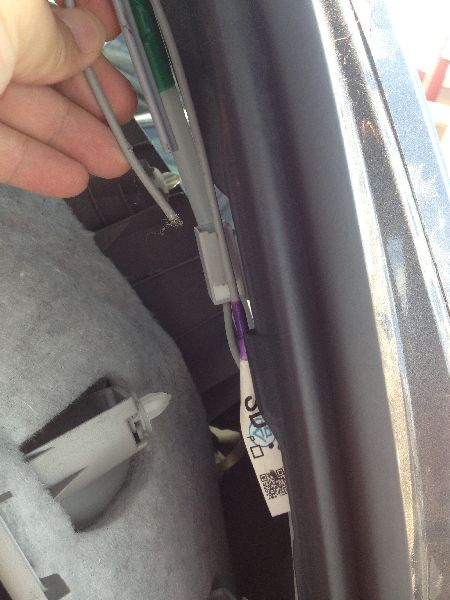

Okay, following up and finalizing the story. I ended up having to drop part of the headliner to remove a roof rack bolt anyway. (see bastard bolt thread) So While in there I traced the micro coax from the xm and saw an empty plug on the rear door frame. Looking for the other end above the headliner I found a mangled micro coax. So yup, it's diagnosed.

Thanks a lot for the explanation in the other thread! Man that really sucks about the broken coax connection you found, are you still going to try to fix that or just leave it as is. I am real curious how that even broke to begin with!
Hey, I'm glad I can actually contribute something useful for once, so no problem. Yeah, I'm wondering too because it isn't just cut. It's missing about a foot and a half AND a male connector.
I did not resolve it. I tracked down that part number. There is a $55 cable and a $90 one with the same part number. Considering the dealership guy thought the xm antennae was the regular antennae I don't have much faith in him to know which to order. I should have taken it to a car stereo place but I got tired of having my roof dismantled and put it back together. I decided that my minute and a half commute did not warrant another monthly bill at this time.
