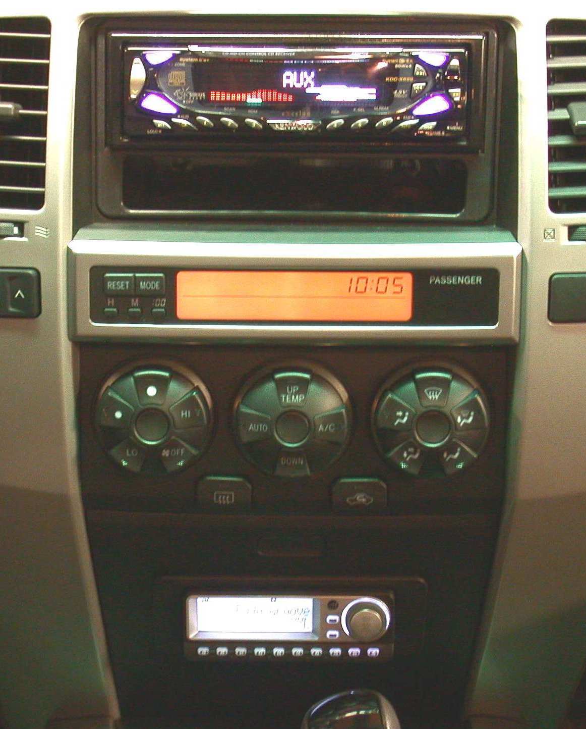

I just installed an XM Commander and a Kenwood eXcelon receiver into my 4Runner. The Commander is running into the Aux input. The antenna is on the dash behind the instrument console.
If by trash. You mean the useless compartment below the controls, it is. I also had to cut out the mount and glue the head at a more upright angle since it was not readable. There is still room to store the remote behind it.
slightly when its down, but 90% of the time I keep it on station 47, so i flip the thing up and forget about it. This reciever will automatically turn on when your car starts, so need to power up everytime you start your car like the delphi.
