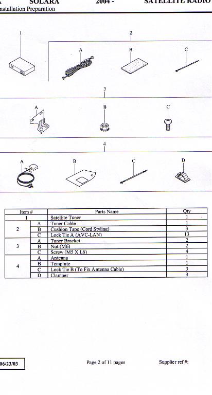

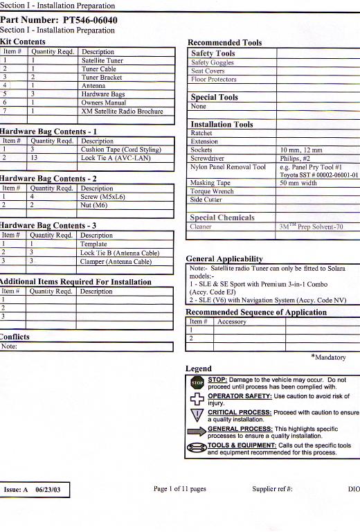

Here is some info on the fully integrated XM tuner for the Solora Radios. Again... this is an extra $488! YIKES!.. but it is a nice solution.
