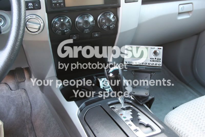

Cheap and still working after 9 -10 years. All I did was add the antenna adapter. The display to the right is my rear view camera.

I have my Sirius set up like Morphius above. I have used a cassette adapter and now a GTA car kit type direct into the CD harness input . Using either the 3.5 mm jack or the iPhone power input and before that the cassette adapter I get an annoying whirring which seem to vary in intensity to my engine rpms. I remember a similar issue with my 1970's era Pontiac ( my first car) with an aftermarket cassette deck (pretty cool in 1979). Does anyone have any ideas how to get rid of this sound or is it something that I have to live with. I am willing to go to a new head unit. Does anyone have a good suggestion that is a plug in replacement that has Sirius or XM module built in or does that have to be purchased separately like it was on the Clarion unit on my boat. Thanks. I may have to start a new thread to get responses but I wanted to get responses from the previous posters on this thread if I could.
I actually found my own answer, alternator noise, and I will check if my power wire and input wire are running parallel and make sure they don't.
That "whirring" sound that increases and decreases with your RPMs is usually indicative of a "ground loop". In the car stereo world, it usually means that something is not grounded properly OR, the ground of your amp and the ground of your head unit are too close together. Not sure why you would be getting a ground loop hum from the 3.5 jack and/or a cassette adapter. Strange.
