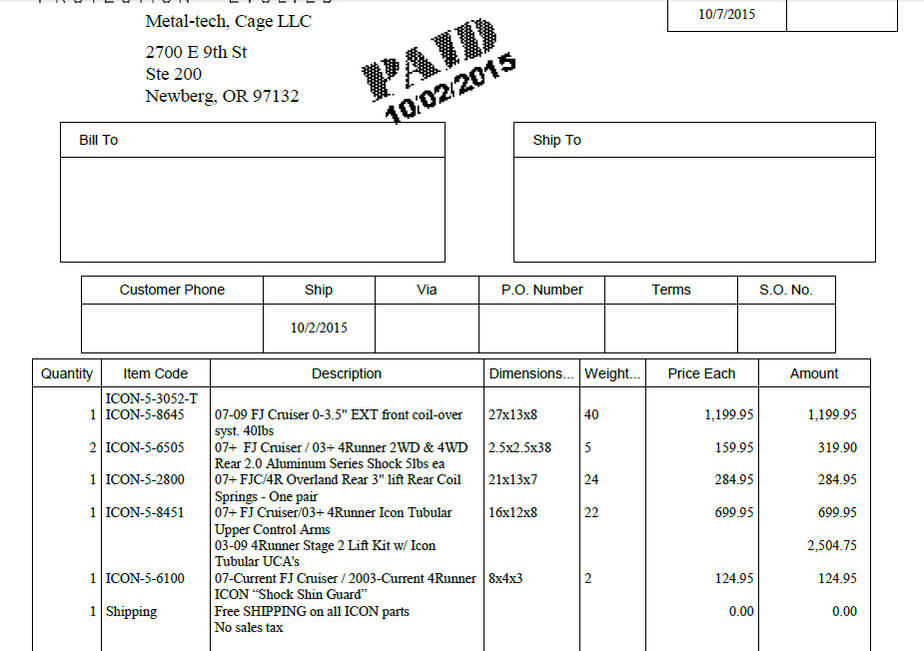

I actually used the dealership quote to get my wife to approve (love you babe) an ICON stage 2 kit. Metal Tech folks know their stuff. Spent a long time researching this, years actually....
Guy on the phone said if anyone gives you lip about spending 2K on a lift kit, tell them to get in and ride with you. :)
I am taking XREAS off and putting the stage 2 on very soon!!!

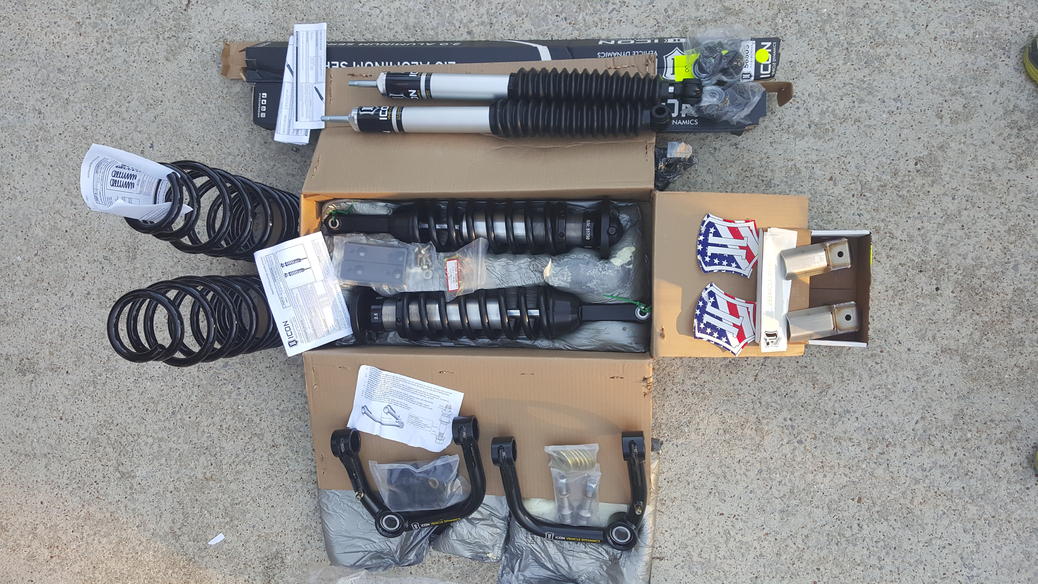

So ready to ditch the XREAS - Oh, look what showed up in my driveway tonight.
