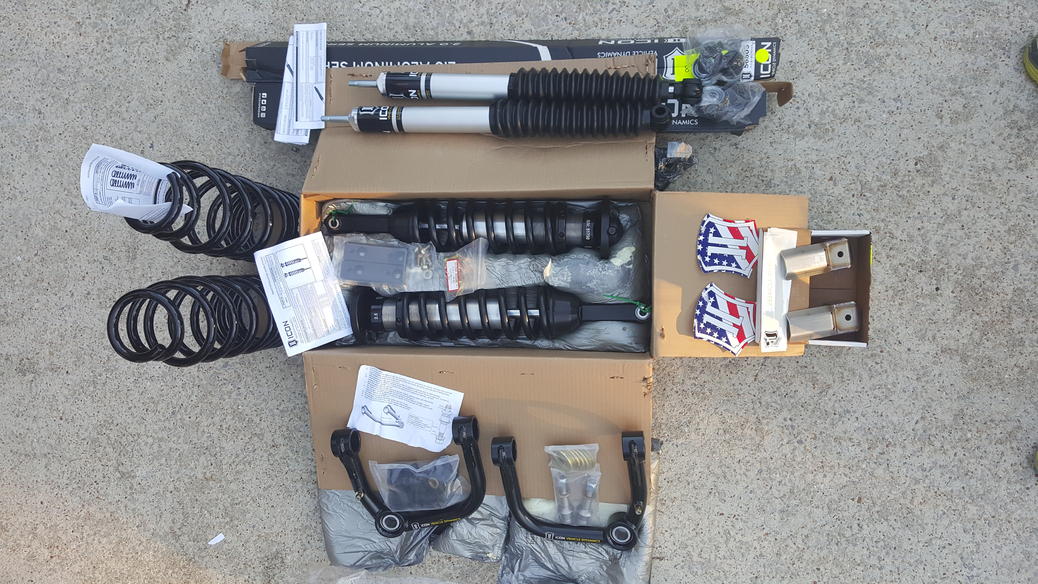

Old thread, but I just went through this with my 03 limited.
Yes those quotes are high, but turns out its a thing. I got a few quotes and was all in the $2k-$3k range here in Seattle.
I ended up deleting the XREAS, and getting a whole new kit for the money.
Boss Coilover kit from Toytec and after shopping around got the labor down to $719 out the door. Soooooo happy with the look and the job that Truline did. 100% recommend.
Wierdly enough I got a $1500 labor quote from Truline Seattle, and a $700 quote from the Bellevue location.
Pro tip, shop around!!
Remove XREAS
Just did the same on my 03 with 175k miles because the back shocks were leaking. I was worried about the impact...I honestly cannot tell the difference.
