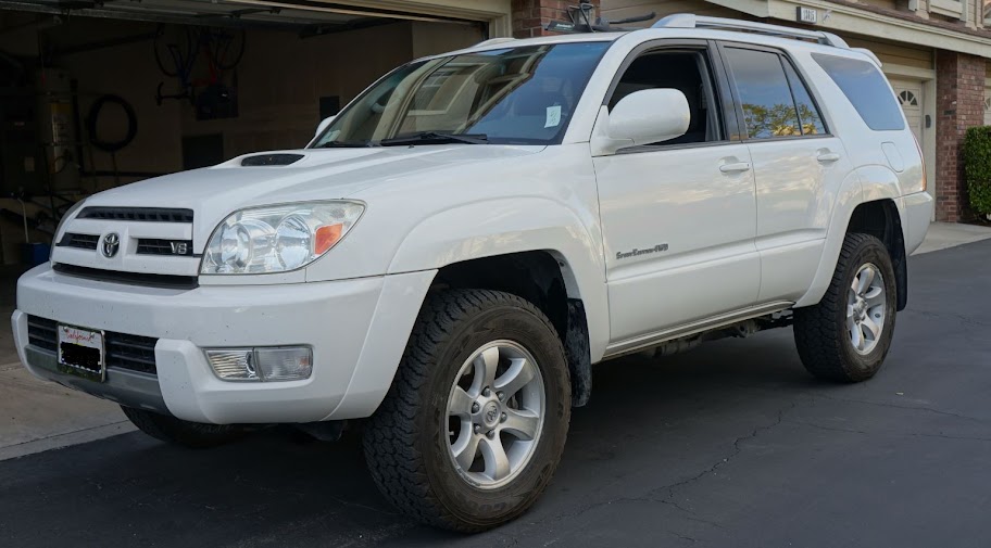

Subject says it all... I haven't taken it in for an alignment yet (I'll do that in a few days when I get back from a quick biz trip) but after doing some brief driving around the neighborhood I have to say the ride quality is excellent. Not harsh or rough at all and it seems more damped and less "jiggly" than with the stock suspension (101K miles and no signs of any XREAS leaks).
Here are the before/after measurements. I have the 5100s set to the 0.85" setting. The tires are Goodyear SilentArmors in the stock size (265/65-17) inflated to 35psi and measurements were taken from the ground to the center of the wheel arches on the fenders:
Before/After/Net Lift
Front Left: 84.5cm/88cm/3.5cm (1.38")
Front Right: 84.7cm/88.5cm/3.8cm (1.5")
Rear Left: 90cm/92.3cm/2.3cm (0.9")
Rear Right: 91cm/92.5cm/1.5cm (0.6")

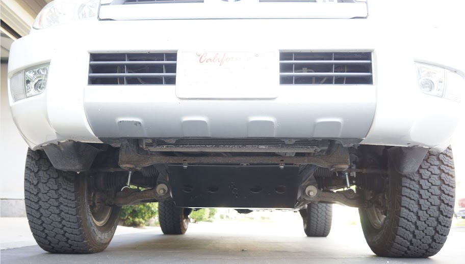

Ground clearance under the front skid plate is up close to 1.5" as well. I think it looks WAY better now, too. This is exactly what I wanted: a mild lift to increase ground clearance up to what Toyota originally spec'd it at in the brochure. Thanks to all who answered my questions earlier about this suspension stuff!

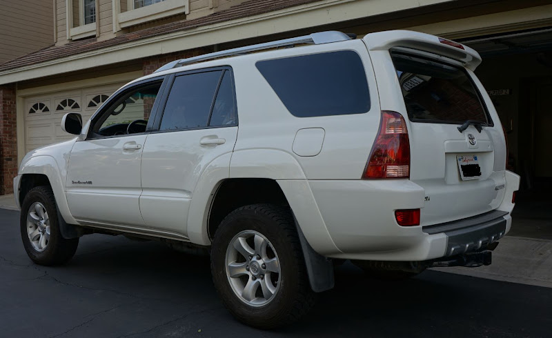

Since I started this thread a year and a half ago I'll give you all an 18-month update:
- Although I started by saying ride quality was better than XREAS, it is not. Impact harshness is definitely greater than before. This is especially apparent at lower speeds, but once you get it up to highway speeds it's quite comfortable.
- There's definitely more brake dive and body roll than before. Some of this may be attributable to losing XREAS but it's also likely due to the center of gravity being higher. Hey, you lift a truck, this is what happens...
- Tires have since been replaced w/ Bridgestone Dueler Revo 2, LT265-70-17, so the truck sits higher than it did before. I also added White Knuckle sliders.
- Truck does great offroad, *for me*. I cleaned Fins and Things in Moab earlier this year on this setup. No need to lift it any higher (and subsequently make on-pavement handling even worse).
Updated pic:
