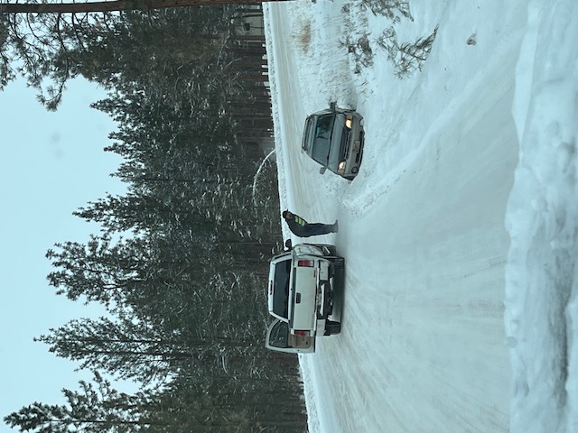

We’re not going 60 mph in snow or ice conditions.
Here’s a pic of an AWD Subaru that went off the road on the inside of the curve at the bottom of our Montana property. You can see what happened from their tire tracks. They came down the hill with too much speed to make the curve. They let off the gas and with the all wheels connected to the drivetrain, they started to slide. Then they got back on the gas and immediately shot into the ditch on the inside of the curve. This is what happens when people get in over their head because they believe their car has hero status with the AWD.

were you and the pickup able to pull them out? the road looks pretty slick I'm guessing probably not
