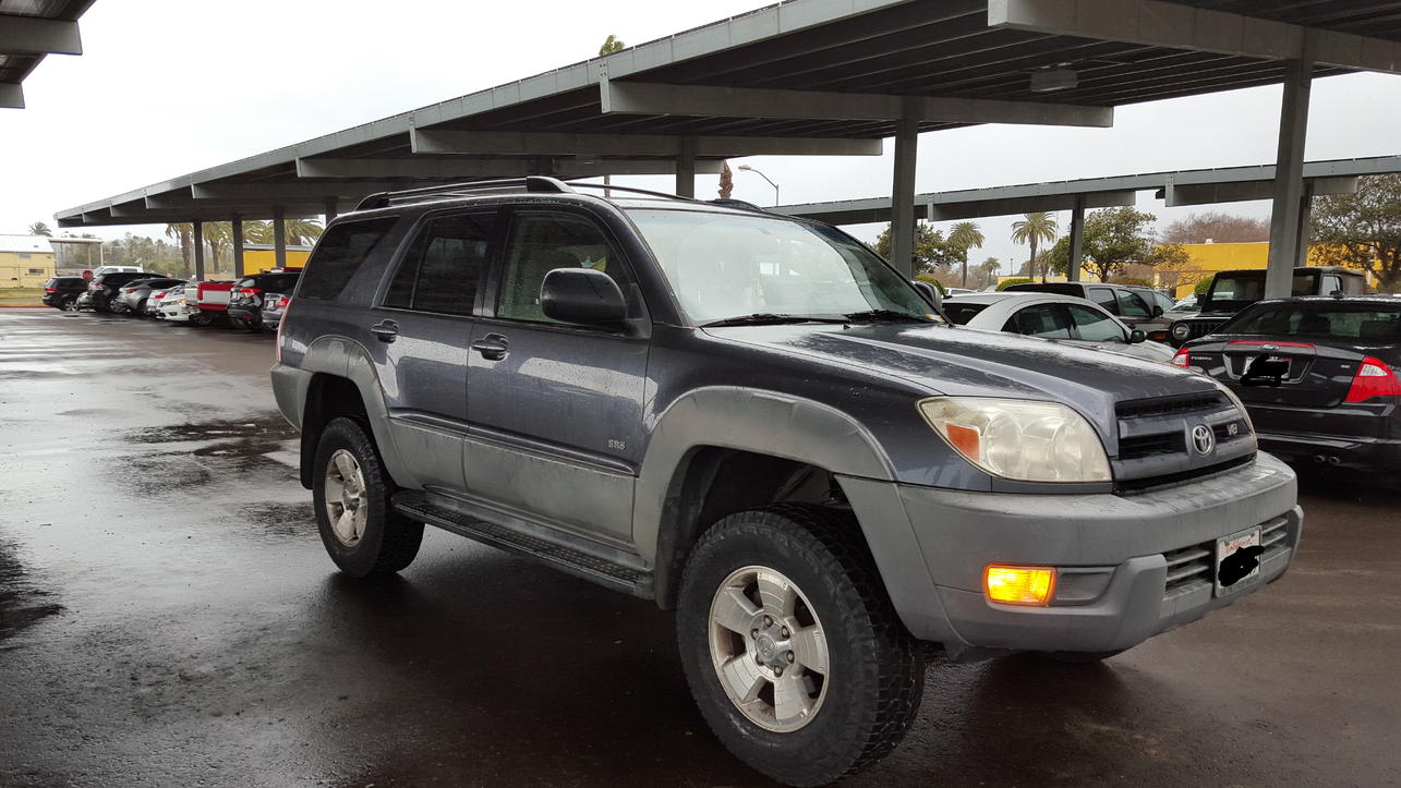

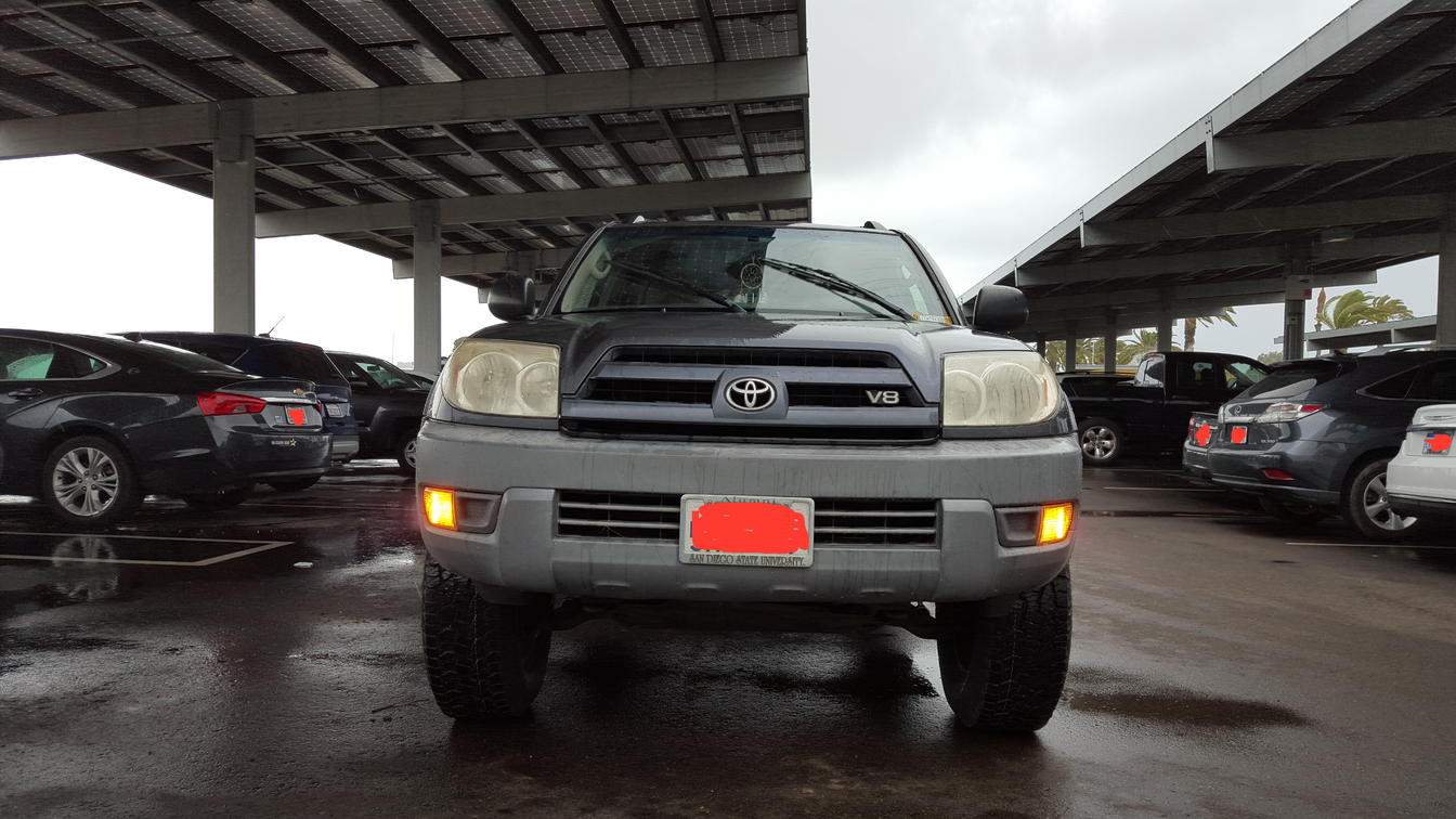

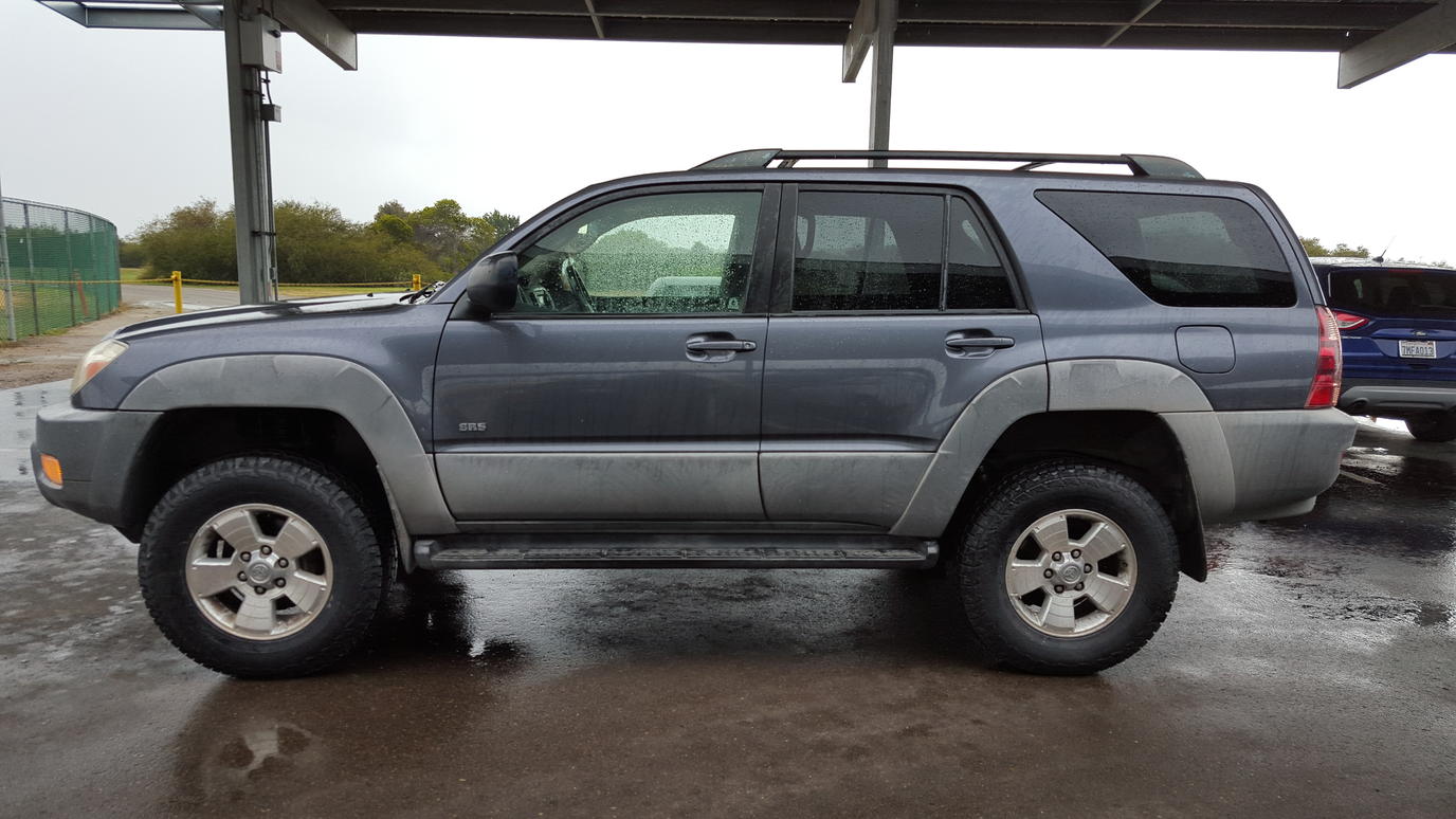

I ended up ordering the Toytec OME setup, with the "Light" OME upfront and the Toytec coils in the back. I will post pictures once it is installed.
An update:
Lift is installed. I went with The OME kit from Toytec. 883 light springs in front, and the Toytec superflex with 60020 shocks in the rear.
Hub center to fender measurements:
Before:
Front 19.5"
Back 22"
After:
Front 22"
Back: 23.75"
New alignment numbers:
Left front:
Camber: 0.9
Caster 0.9
Toe: 0.02
Right Front:
Camber: 0.6
Caster: 1.2
Toe: 0.04
The lift changed something with the steering, it was extra stiff with the wheels straight ahead. At first I thought this was an alignment problem, but I've narrowed it down to the intermediate steering shaft. I guess the lift exasperated the already old part. For now some lithium grease has fixed the steering problem.
The rear end bounces A LOT on a 55 mph concrete highway near me. There is some resonant bouncing between 55 - 65. I aired down my tires from 40 - 30 PSI, and that helped some. I will throw some weight in the back to also help. I hope the suspension wears in and this problem goes away. It drives fine on asphalt highways, its definitely a resonance problem with the concrete expansion joints.
