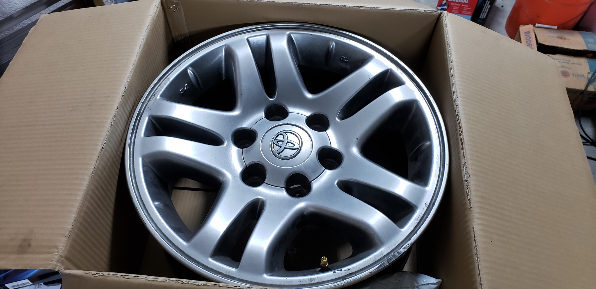

See if you can find some Sequoia caps. Looks like they will fit and don't stick out.
Good idea, I'll check them out! I'll have to look at the stock SR5 wheels and see how much their caps stick out for comparison. Although, they're a much lighter aluminum type color, whereas these FJ wheels are a bit darker. I do believe the sequoia wheels though did come in the same color as these FJ wheels. Thanks!

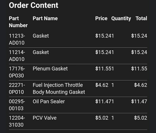

May as well do the cam gears if your doing the gaskets! The gears literally take maybe 5 more minutes if doing the gasket job. Here's the gaskets I bought for the job. Both valve covers, intake plenum, throttle body and a PCV valve. All from McGeorge online, great prices. I'll send you my tube of FIPG for the gasket packing if you PM me your address. The "oil pan sealer" is the FIPG. It's about $65 for all the gaskets shipped give or take.
Sent from my SM-G986U using Tapatalk
The cam gears definitely seem like a good move to do while in there for the valve cover gaskets! Initially was worried about pulling the timing cover for the gears, but now I know thats not required from when we last discussed it, and it seems a lot simpler than I was initially thinking. I'll have to get over on the TW thread and read up some more.
Thanks for the PNs and FIPG offer, I might have to take you up on that! McGeorge does have good prices, I just wish they would sell them at their parts desk for their online prices lol. Might be summer or spring before I can get to some of the bigger projects, we'll see.

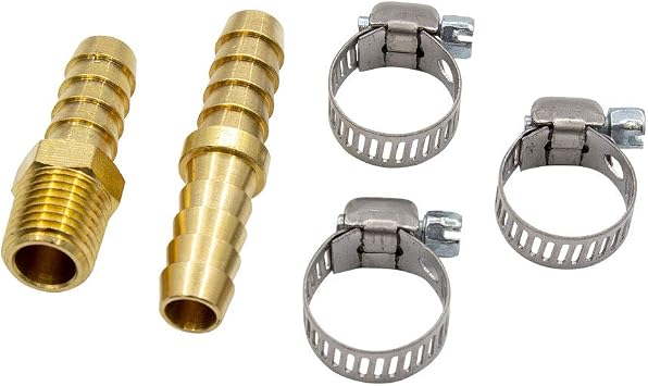

Do you think the splyce barb is enough to keep them together or have you put a metal clamp on it since you made the post?
I just followed what you did and rerouted my ac drain too so thanks for that! My splash guard was in the way though so I only zip tied it in the one place near the bottom of the frame so hopefully that's enough to hold it.
Do you think the splice barb is enough to keep them together or have you put a metal clamp on it since you made the post?
Sweet, thats great! I think it should be okay with just one zip tie. I actually found my splash guards with some older parts, so I'll have to see how mine ends up fitting.
For the barb, I haven't put any hose clamps on it, but it certainly wouldn't hurt to do so. I haven't looked extensively for small hose clamps, but they may be hard to find in that size off the shelf, I dunno. But lots of air compressor hose repair kits have some nice and small hose clamps that would probably fit perfectly. It just occurred to me while typing this that a 3/8" air hose repair kit would have all the parts: the barb and some little hose clamps!
Yea I saw the clamps that would fit at Lowes I just didn't grab one for whatever reason. I might grab one next time I'm there just in case cause it wouldn't hurt
