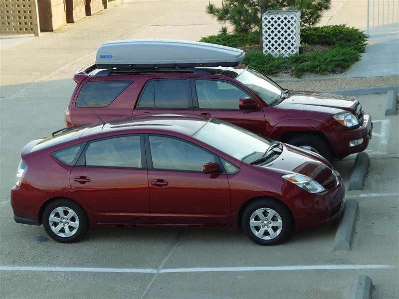

I have used an enclosed box and had no noise what-so-ever.
Thanks for the suggestion Koz.
I just measured my garage door. It is 84" high. My crossbar height is 70". I haven't found a luggge box under 14" high so I think I'm SOL. I also plan to do a 2"-3" lift before spring so my roof top options are limited.
