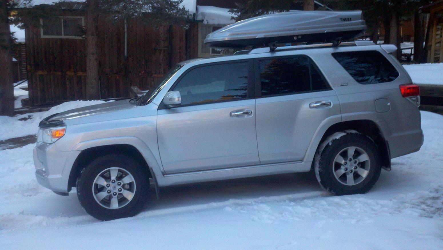

Those look real nice up there. I have an ole pair of Thule bars that I throw up on top when I need to use the Thule Box. I might have to look at upgrading at some point in the future....
