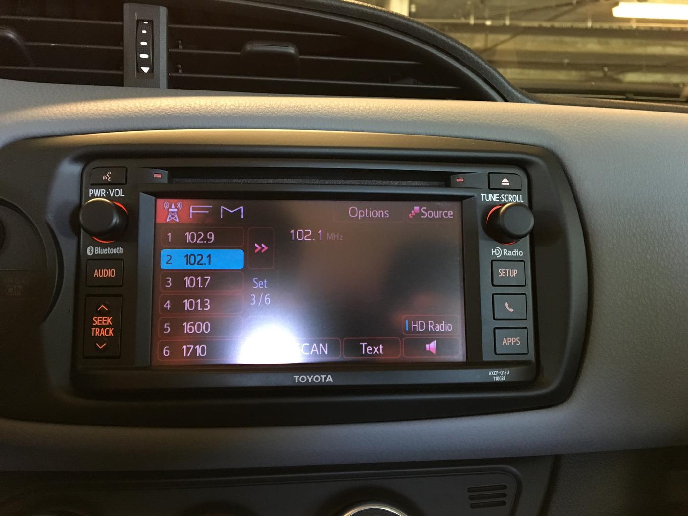

So I was inside of a rental Yaris, a 2015 and it had a pretty clean stereo. It was double din and touch screen and I thought... Wow that would look great in my 02.
Has anyone ever done anything new like this. Can I even squeeze the radio in my 3rd gen and would they make the pig tails for it or would I just have to solder everything myself.
Anyways, the model number is AXCP-Q15U
Here's what it looks like

That outta the way, a quick Google search turns up pages of pictures.
The mounting points actually look like the mounting points on 4Runner head unit brackets.
Can't tell you it will fit/work, but I am very familiar with the Toyota truck head unit brackets, and- from the little I can see from the pics posted- they look the same.
I vote you buy one and give it a shot [emoji481]

It LOOKS like it'll fit, but with no reference objects it's hard to see the true size. If you get a couple measurements I'll compare them with the scion headunit I have sitting in my garage. Those are known to work.
The chassis whether single din or double din, will fit. Also, the front face seems to be a standard din size vs oversize.
Having said that, mounting brackets from your 3rd gen can simply be transferred to the new radio (which is most likely a Pioneer btw).
Toyota power/speaker harnesses have been the same since the '80s so there should be no change and since it's just a regular radio, plug 'n' play.
Can you post a pic of the rear of both decks for us to verify?

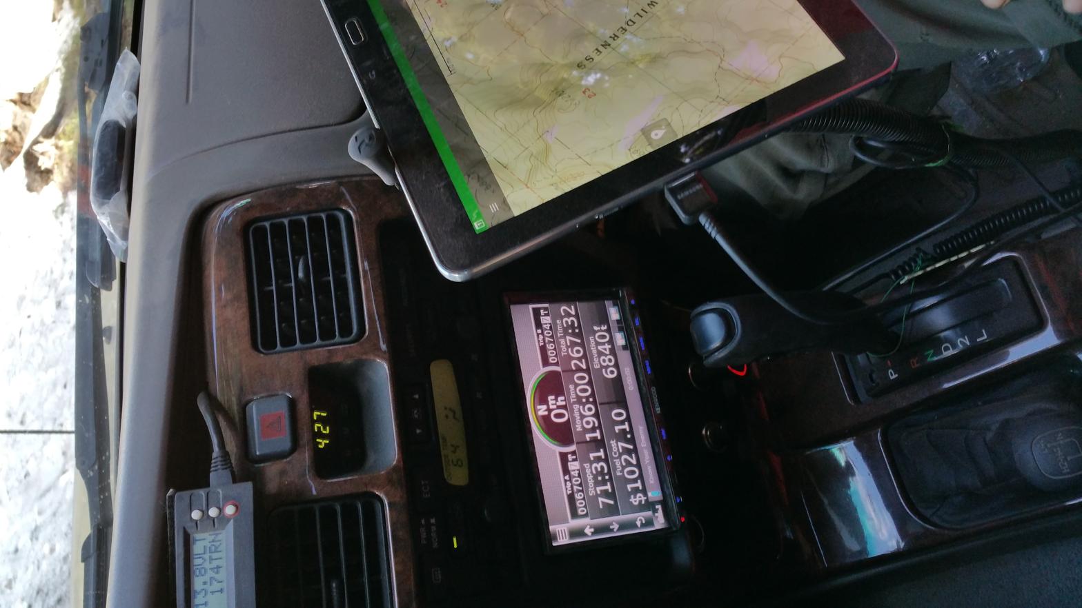

I picked up this for the same price as the Yaris stero and I prefer it. It's also a double DIN.
I also give up on why the image rotates when it was fine and correct when I downloaded it. /me sighs.
