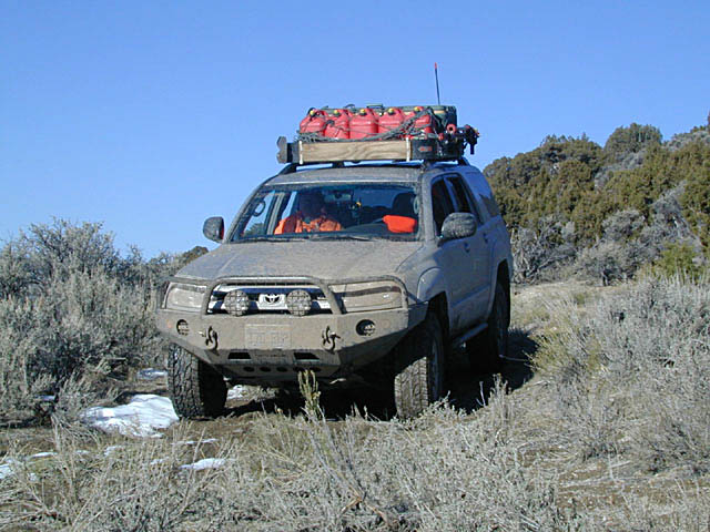

Gas can on the roof ???
Hmmmmm .......

This pic taken from the Shrockworks website... Seems like a lot of gas hangin' out over your head. You would need to be aware of the expansion factor as well as these heat up in the sun. The roof is probably the safest place to carry extra fuel tanks; aside from a rollover, they are out of harms way on the trail.
As far as exploding; I assume I'm stating the obvious but make no mistake, gasoline with its rather high vapor pressure, vaporizes very quickly and is explosive, especially in warm conditions. The extremely rapid rate of combustion of gasoline vapors and the associated expansion of the gases is by definition, an explosion.
For what its worth: A BLEVE (Boiling Liquid Expanding Vapor Explosion) is an explosion but there does not need to be any combustion involved. They are a product of a rapid pressure change (a drop) that causes an even more rapid pressure change (a rise) due to the rapid/uncontrolled vaporization of the remaining liquid inside a closed vessel. The subsequent pressure rise is what causes the explosion of the containment vessel. There can be combustion but not necessarily.

I'd be afraid of having extra weight in an off-camber situation. Plus if you got like 14 little 1-2 gallon tanks, think how many times you would have to stop to relieve pressure in the tanks if they weren't self regulating! It would be annoying as hell.
If that second row of cans are for water then I'm guessing that they are carrying about 350 lbs on the roof ...
