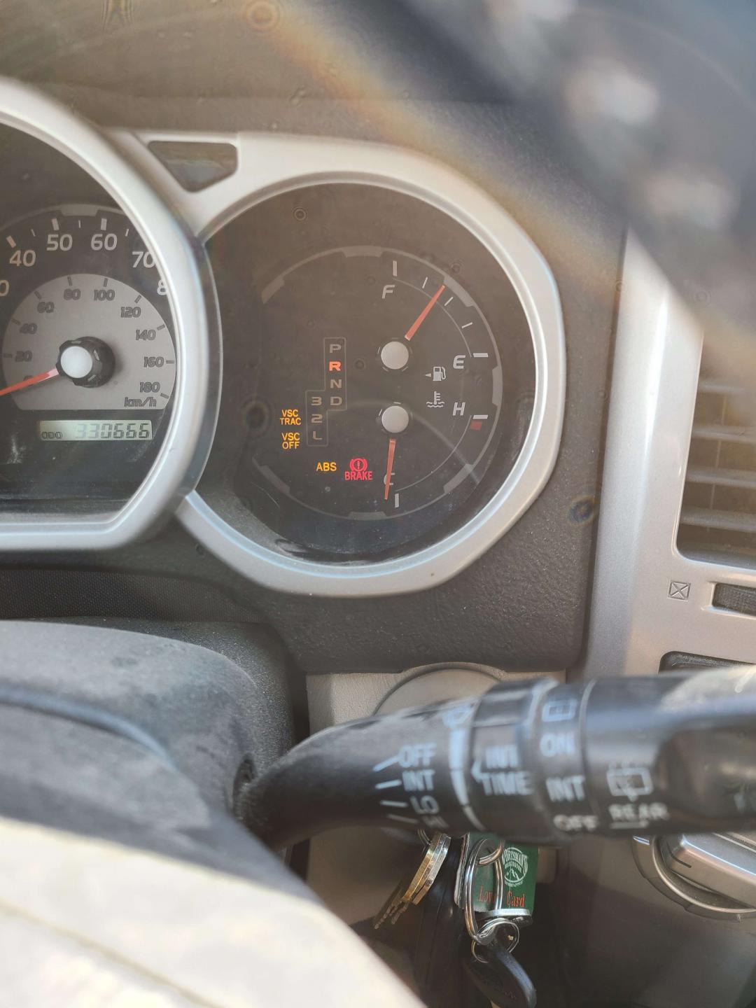

All this and then some. NEED HELP!
04 4Runner V6 SR5 4x4:
So I have Both VSC lights, Break Light, ABS, and the Code reader I used Said P0500. Speedometer and Odometer stopped working When I use my cheap scanner while driving it says its not reading the Speedometer Either. Cruise Control doesn't work.
THE STORY:
Before all this, I had VSC lights and ABS Break Light came on and off at times. Then it got parked for 4ish Months as winter came on this year as I had medical issues and wasn't allowed to drive. Jumped it early Jan of 2023, worked fine, wife drove it to car wash and parked it. 2 weeks later I Started it, worked fine. Then last week I started it, had to jump, got it going, sounded like crap, turned it off, waited turned back on the next day, no jump required sounded better. Engine Light, P2118, replaced fuse Gas pedal works, 4runner drives fine, all good? Nope Code P0500 is on. Drives smooth shifts smooth, but the rest mentioned above is broken, No check engine light returns. Seems like maybe Speed sensor on transmission, But it does shift smooth. Could be wheel speed but why now no Speedometer? Why not before that day? So is my computer messed up? Or just bad sensor got worse? I don't know what to test or check to find out before I buy parts waste a bunch of money I don't currently have. thanks in advance to anyone who helps.
