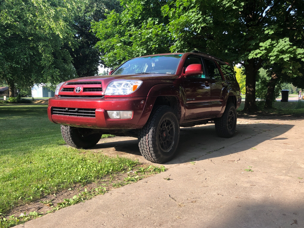

Well I pulled the trigger and bought the 285/70R17 Terra Grapplers. Can’t wait to get them on and post up some pics!
Action shots will have to wait until I fix the HG...[emoji51]
The truck rides awesome! Honestly I didn’t notice a difference drivability wise. I took my air saw to the front of fender liners to stop the rubbing. Tiny bit of trimming still required but it wasn’t nearly as big a deal as I thought it would be. Last time I aligned it I moved the Caster as far forward as it would go. This probably helped with clearance behind the tire since no trimming was needed. Anyone considering 285/70R17 DO IT!
