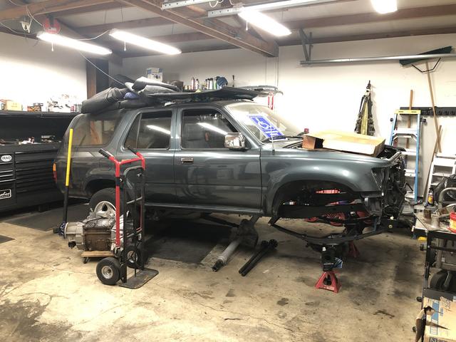

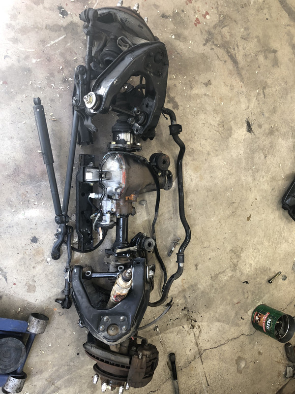

I did some cleanup and tear down of the front end. Insides look good and it’s a factory 4.10 axle.

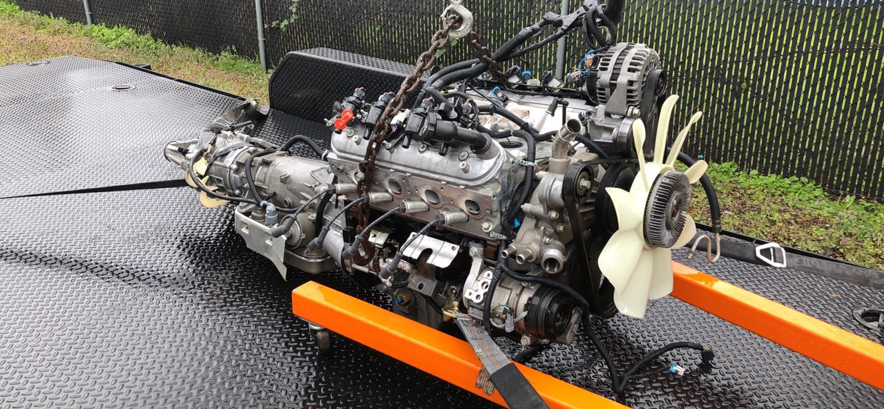

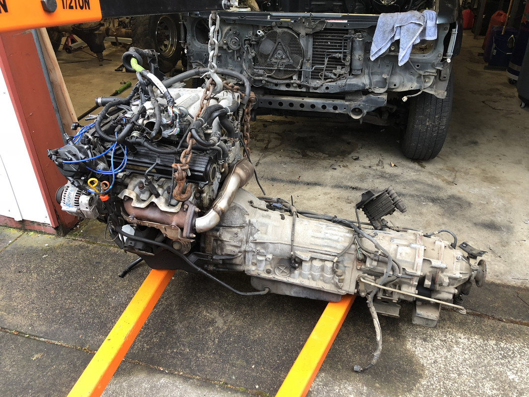

Well more pieces are coming in. This is a 5.3 out of a Tahoe. I’m going to put a cam in it and run it. Trans and t-case aren’t needed. Going to sell those. Need to find a NV4500 and pony up for the atlas 4spd.
Almost time to start cutting and welding!

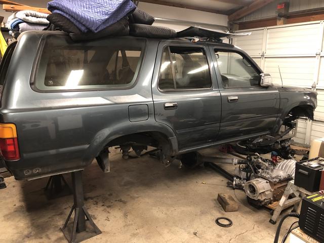

Found some motivation to get some stuff done.

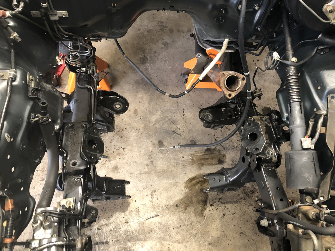

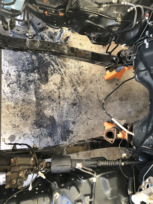

IFS pulled out
Got the liquid wrench out and started cutting all the frame mounts off.

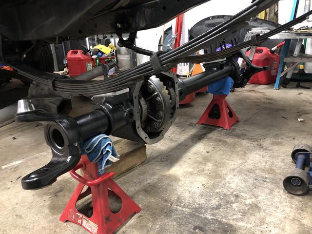

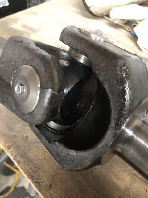

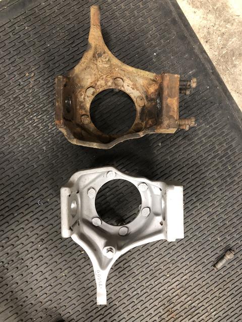

I got the front end setup with a Detroit and Yukon 5.13, Yukon chomo 35 spline inners and outers with Yukon super joints, barnes 4wd high steer arms.
The rear now has a Yukon spool and 5.13s with Chromo axles.
Got some used 63” Chevy springs from a friend and I found some used 5” non-hd trail gear springs local. The front spring hanger is now burned in and shackles are set.
