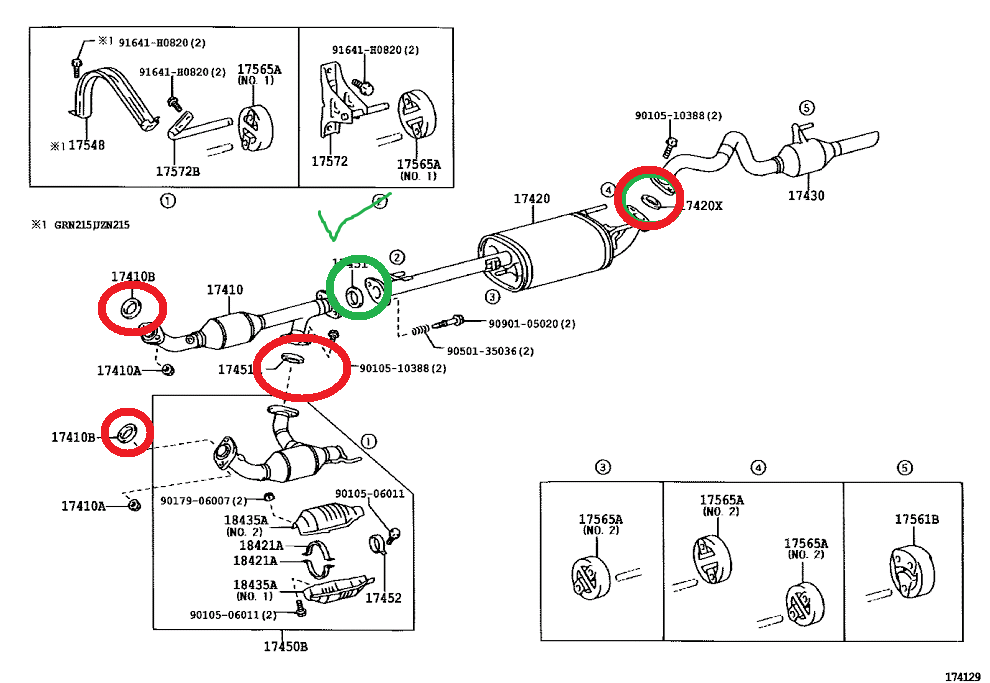

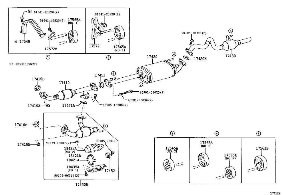

Yeah, makes sense. Any pointers on where the other gaskets are, and part #s if possible? Logging all the exhaust system part numbers in this thread would make it a very useful lookup for future users in the same boat.
Only one gasket downstream of the one you already replaced. Maybe it's that one?
wow, you are awesome!
I am looking at the parts diagram you posted, and I see all these different gaskets?! All the ones I circled in red.
You think I need to replace all of 'em or just the ones downstream of the y-pipe? I'm not sure if all of them are even accessible without major work?

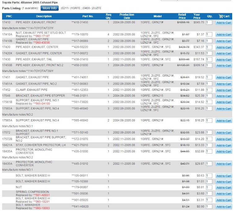

EDIT: Also, I'm having a hard time finding those part numbers. For 17451A for instance, is it 17451A-917-06083? What does the "**" stand for in the part number diagram? Sorry for newbie question.

I'd start with the easy one first. The gaskets near the cats are going to be a real pain to get to. Since you said the noise is coming from somewhere near the resonator, it makes sense that this one would be the issue.
As far as parts numbers go, they are the ones in the "Part No" column. The "**" is just the website being stupid and not showing you the whole part number until you add it to your cart and place your order. I didn't realize it did this, and I'm not sure how to work around it yet.

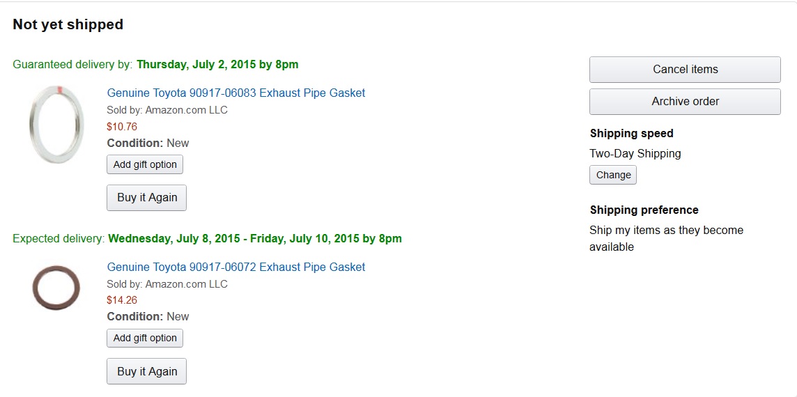

Thanks again sonerik. I clicked through in the cart and found the part numbers, and bought them on Amazon (with prime shipping, I get it fast and also dont have to worry about creating account, putting in card number, address etc.)
I went ahead and ordered the gaskets immediately upstream (17451A) and immediately downstream (17420X) from the one I already replaced. I will report back once I fit these.
