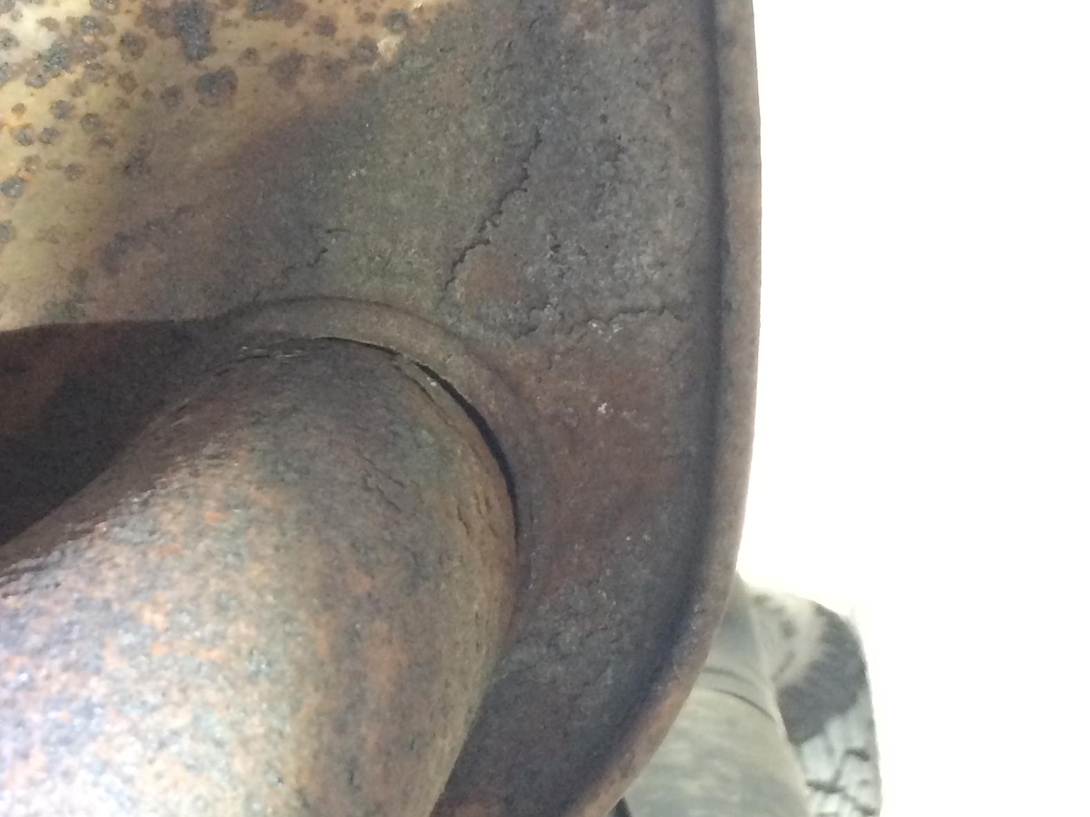

Sorry for reviving an old thread here but I just recently, last night, started to hear a rattle that sounds like its coming from the rear of my truck, passenger side. Its an 04 V6 with about 150k miles. I took a closer look this afternoon after work and it seems to be an exhaust rattle that only happens while in gear at low rpms. I plan to get the truck on jack stands tomorrow to get a closer look and check all the heat shields. However I did notice a small gap where the rear exhaust pipe comes out of the back of the pipe assembly (part 17420 above). I've attached a pic below and also uploaded a video of the rattle noise.
I'd appreciate any input for what to look out for when I get under there tomorrow. I plan to check the y-pipe gasket as well since it seems like this is a common cause of exhaust rattle. Obviously heat shields will be checked as well.

After reading through a lot of posts regarding the rattles on 4th gens, I finally found my culprit.
The source of the rattle was loose A/C Compressor bolts. I poked around with a stethoscope and was able to pinpoint the issue.
The rattle was only present while in gear (drive or reverse) in the 500 to 1000 rpm range. Sometimes turning on the A/C made it go away, other times it didn't change it all.
Hope this helps some of you!
