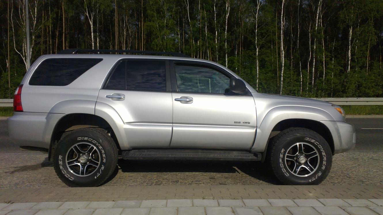

Finally had time to do this.
Bilsteins 5100 shocks all around. Front set to 1.75. Daystar spacers 1.5 in the rear. New Cooper Discoverers A/T3 265/75R16.
It rides sooo good... More stable when turning. Higher means better. Now it looks like a decent rig.
I started to consider 2.5 setting but first off I want to drive more with 1.75, second its enough for now spending evenings under the vehicle, third I expect to have issues with UCAs/alignment as I had so far. I also experienced a bit fender rubbing on the passenger side.

I suppose it will be an issue because clearance between UCAs and springs is very limited when the viehicle is jacked up and wheels down.
I know, the sticker thread says no UCAs necessary until >=3" lift. But it also says no trimming when ~2" front lift with 265/75/16 tires. It wasn't true for me.
