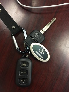

Ok.....so I did some researching/digging. I cannot figure out why my truck will not go into programming mode.
my observations: when I lock the truck, I do not observe the little red blinking light thats next to the steering column start blinking. Possibly disconnected?
I was told this remote would work by my parts guy at Toyota. He ran my VIN, and said it came with factory keyless entry.
I tried the variations of the programming sequence to no avail. Possible bad body ECU or a ground somewhere?
I'm wondering if this ties into the fact I cannot use my key to lock the doors, but it'll work in the hatch, the glovebox, and the ignition.

yeah. Mine is factory installed (99), so the box isn't under the drivers seat. I checked there for it. Key unlocks the drivers door, locks and unlocks the hatch, locks and unlocks the glovebox, and works the ignition.

I cant even get the truck to go into program mode.
Use key in driver's door?
I had the same struggle a few weeks ago. It didn't work until I rolled down the driver door window, propped the door open a bit, reached out through the window, then used the key to manually lock/unlock the prescribed number of times. Various sources say to "use a one-second count" but I just turned the key again when the lock cycle finished; it was pretty quick. You have 40 seconds to move the key to the ignition and it worked fine.

Can't use a key to lock the door, which leads me to believe this is part of the body ECU issue. I saw that someone else was having the same issue.
During my attempt today at lunch, I couldn't get the truck into program mode. I turned the truck on, hit the lock switch, and the locks locked then immediately unlocked, which further leads me to believe that the body ECU is toast.

I didnt know the part about the truck not letting you lock your keys in it, if it is in park and the key is in the ignition with the truck running. That was just to see if i had messed anything up. When i turned the truck off the lock switch wouldnt work at all for a minute or to lock or unlock any of the doors.
I also attempted to assist with with my hand on the "plunger", following the directions as stated in the programming threads, to no avail.
