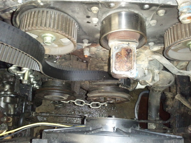

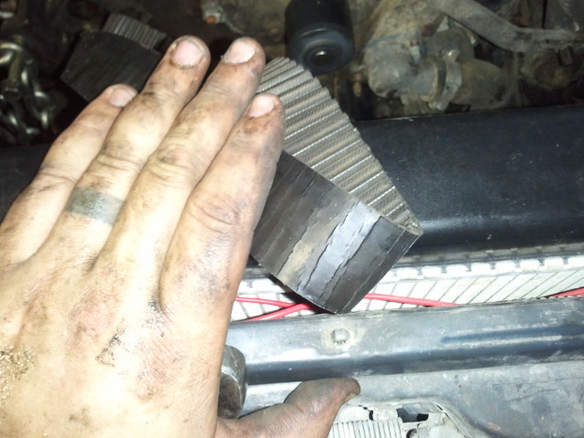

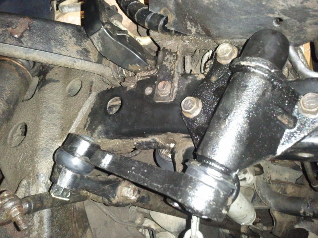

1. I'll just replace this worn out steering idler arm and be done.
2. Oh, look. The boot on my stabilizer is shot. I'll just replace that with a spare.
3. I thought the last owner just replaced the timing belt.
4. why wont the crank pulley bolt come lose?!?!
(I had to bolt a chain to the pulley and run it arond the back of the Ac pump to hold the crank in place)
:gun6: :dammit: :lasercannon:

Put an impact socket on your breaker bar and put it on the crank bolt so the bar is under the passenger side frame rail but as close as possible. The bar needs to be long enough to reach under the frame rail - shorter would be bad. Make sure there's no hoses or cables or anything between the bar and the frame.
Disconnect your ignition coil, or pull the EFI fuse or something.
Turn the key. :)

That bar trick worked great KidVermicious.
Thanks
