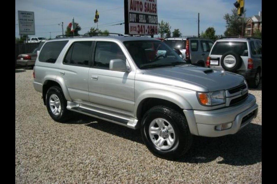

2001 Sport Edition 4x4.
I originally purchased the T4R as a second vehicle in 2013 to keep miles off my truck I owned at the time due to an hour long drive into work. After several months I realized this was the only thing I drove, sold my truck, and paid this off. I joined the forum to get information on how to perform my own maintenance but have since modified & benefited from so many great write ups and builds and feel the need to give a little back.
As of Feb. 2018 @ 218k miles
When I purchased in Feb. 2013 @ 144k miles for $7200 out the door. 2 owner vehicle I got from a small mom and pop dealership in Austin. 1st owner purchased in SoCal and 2nd in Arizona I believe.

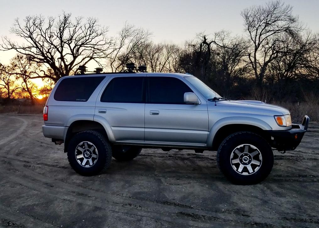

Those TRD rims look great. With the locker, winch, and other mods, hopefully you'll take her out wheeling!
I usually get out to some parks about once every 2 or 3 months. But because it's kinda the same ole, just a different park. To kinda change scenery, I have started planning out some adventure trips this next year that will probably be between 3-5 days here in the Tx, Ok, Ar area.
