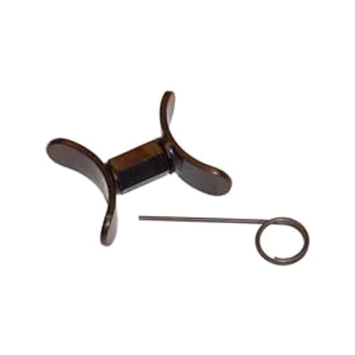

Schley Products 97300 Timing Belt Tensioner Compressor:
This little guy is a LIFESAVER. 5vzfe hydraulic tensioner is not fun to take out. This little guy makes the job take a few minutes vs 20 - 30 minutes and several 4 letter words. You do NOT need to buy the snap-on version which costs a ton. This works the same way and runs about $40 shipped if you shop around.
Notes on using this product:
- This goes between the WP pulley and tensioner pulley. When turning the nut to compress the tensioner, it takes quite a bit of force and GO SLOW
- You want to use this with the old WP and tensioner installed as it can scratch or scar the pulley surfaces. So use this as step 1, then replace the WP and tensioner pulley that you should have already purchased!

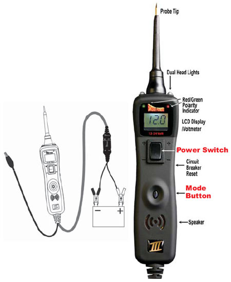

Power Probe:
For electrical testing and troubleshooting and such, one of the best tools for the job (quicker and easier than a multimeter which you should also have) is a power probe. This tool lets you quickly and SAFELY test for positive / negative / gives voltage readouts AND can send positive or negative with the touch of a button. The kit is expandable and has lots of options. I have a version 3 model but the V4 looks pretty nice.
http://www.powerprobe.com/

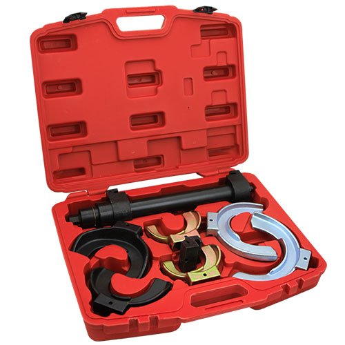

Goplus Macpherson Spring Compressor:
You will not find a person on this planet that hates a cheap spring compressor more than myself. I actually had a harbor freight unit come apart a few years ago that injured my wrist. I still live with the pain today. This compressor has been one of the best purchases I have ever made. Cost is about $80-100, it is built like a tank and makes compressing a spring quick, easy and safe. Literally a no stress tool.

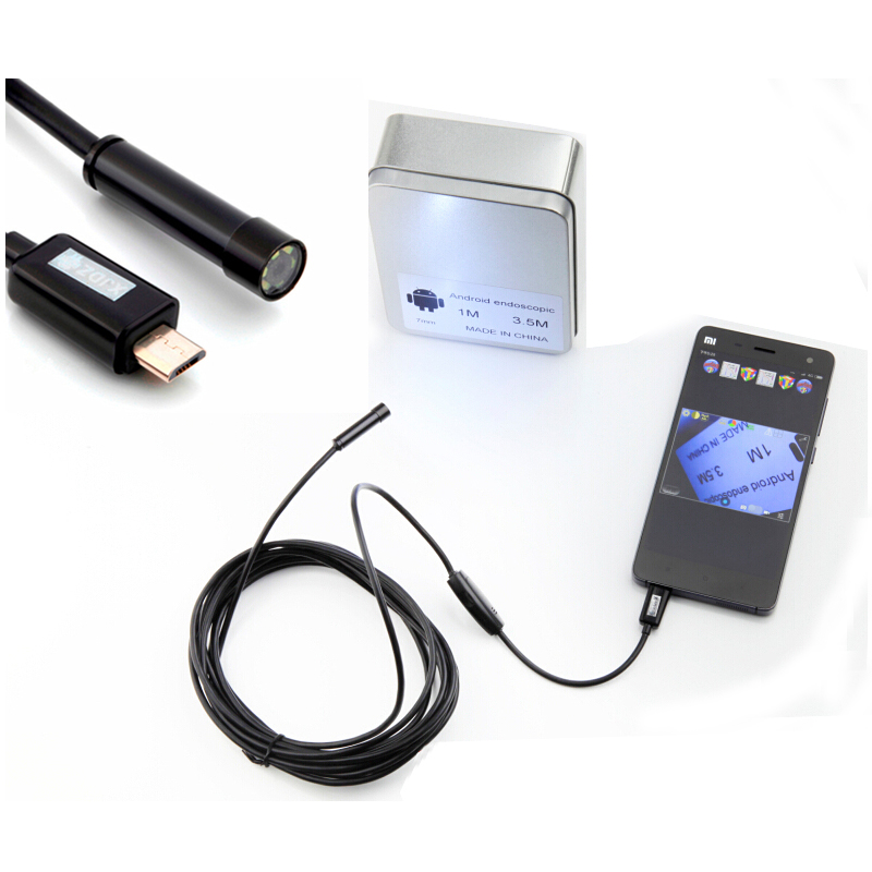

Endoscope for android or other:
They are CHEAP and can be purchased on ebay. Lets you stick the camera into places normal cameras will not go (please keep it automotive :) ) They do not come with software, but if you download a free app called CameraFi / works perfectly
1 5 2 3 5M 7mm Android Endoscope Waterproof Borescope USB Inspection Camera USA | eBay

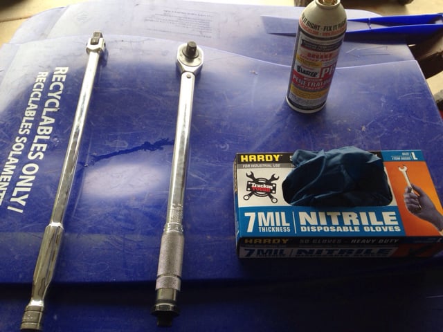

Ditto on that PB blaster :) Excellent penetrating oil.
+1 on the Schley 97300 tensioner compressor, 18v cordless Impact, PB Blaster and Nitrile gloves.
